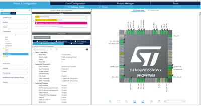

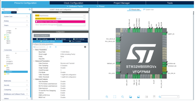

I'm using a NucleoWB55 and trying to use UART to print a message on a tera term terminal. When I let the default pins (PB7, PB6) for USART1_RX and USART1_TX I'm able to transmit and print a message correctly with the HAL_UART_Transmit_IT function. But I would like to use these pins for the I2C communication so I would like to put USART1_RX on PA10 and USART1_TX on PA9. This is the only changes I make. The TIM1_CH that used to be on that pin are simply disabled and I'm okay with that. I save and regenerate the code and the pin a correctly modified. BUT nothing happens on the terminal and nothing is printed. Do I need to do something else when I change my pins location?
Thanks a lot, you can see below my 2 configurations :

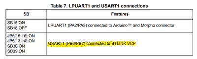

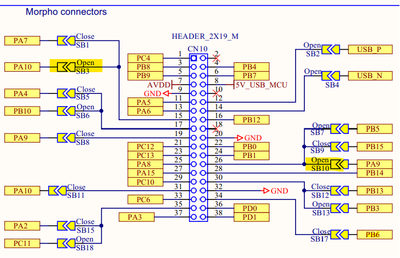

No other changes are needed. However, these pins need to be connected to whatever you're using to get the signal to the computer. This may require solder bridges to be opened/closed if you're accessing via the headers.
Only PB6/PB7 are intended to be used as the VCP for USART1 and have the native connections on the board.

So how are you making the connection from PA9,10 to your TeraTerm?
As @TDK said, they are not connected to the USB-to-UART "Virtual COM Port" (VCP) of the ST-Link in the Nucleo board - so you'll have to make some other connection.

So those pins are connected to the VCP of the ST-Link in the Nucleo board - if you want to use them for I2C instead, then you will need to break that connection...
