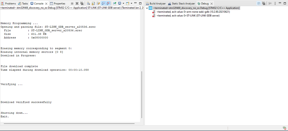

Something wrong with my gdb in stm32cubeide
BAl K.1
0693W00000Y7CANQA3.pngWhen i run my code, something wrong with the gdb (like in the picture). Someone can help me pls?
Rim LANDOLSI
It is a normal behaviour when making run. If download is verified successfully, GDB session will be terminated that's why you see "terminated arm-none-eabi-gdb" in the debug window.

What's in the console?
BAl K.1
0693W00000Y7CHsQAN.pngIt says download successfully, is it run properly or not (with terminated arm-none-eabi-gdb)??

is that the gdb server log-file??
Rim LANDOLSI
Hello BAl K.1,
Are you sure you are using the right debug button looks like you are using the run button?
Yes, i use run button, i want to run the code and that error appearing. is there any solution for that??
Rim LANDOLSI
