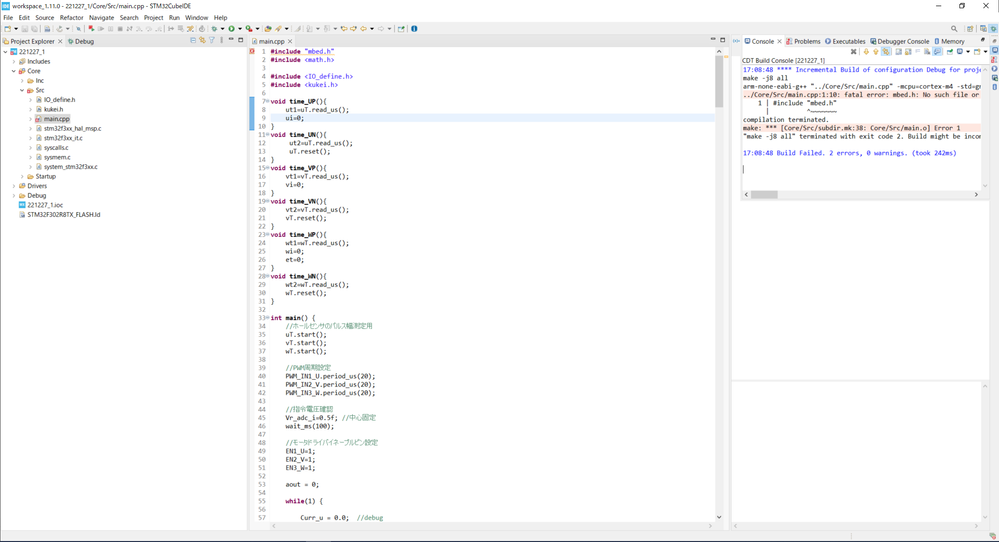

�?�在�?�ステータス:I次�?�図�?�示�?�よ�?��?��?2 �?��?�ヘッダー ファイル�?� 1 �?��?� cpp ファイルを mbed �?�ら Core/Src �?�イン�?ート�?��?��?��?�。�?��?��?��?cppコードをコンパイル�?�る�?��?無数�?�エラー�?�発生�?��?��?�。
知り�?��?��?��?�
ヘッダーファイル�?��?�る場�?��?�?��?��?�れ�?�デ�?ッグ�?��??�?��?��?�?
エラーを解決�?�る方法(�??�?�よ�?��?�ファイルやディレクトリ�?��?��??�?�?��?�スコープ�?��?�ダクラリング�?�れ�?��?��?��?�ん)?
画�?内�?�cppプログラム�?�変数を読�?��?�る�?��?��?��?�能�?��?��?�?�??�?��?��??れを�?��?�よ�?��?�行�?��?��?��?��?�?
�?��?��?��?�教�?��?��?��?��?��?�れ�?�幸�?��?��?�。
プログラム�?�長�?��?��?��?�?��?��?�を画�?�?�添付�?��??�?��?�ん。

" Current status: I have imported 2 header files and 1 cpp file from mbed to Core/Src as shown in the following picture. But when I compile the cpp code I get countless errors.
what I want to know If I have a header file, how can I debug it?
How to resolve the error (no such file or directory and undeclared in this scope)?
Is it possible to read variables in a cpp program inside an image and how do I do that?
I would appreciate it if someone could tell me.
The program is too long to attach everything to the image."

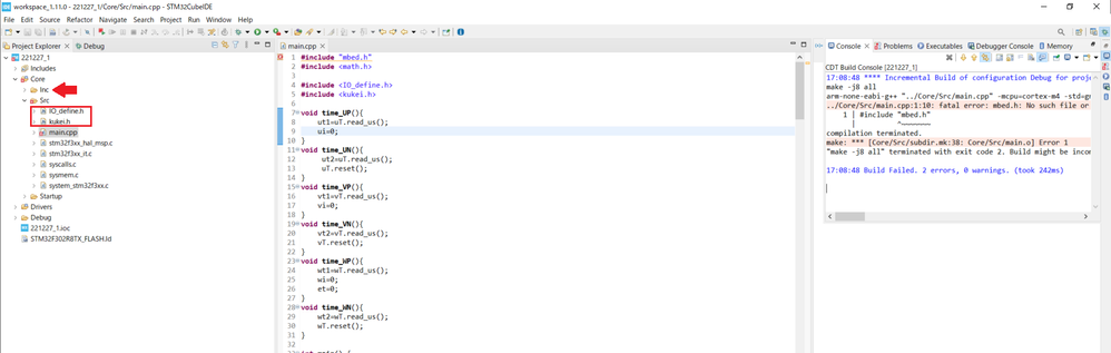

If I understood well your problem and regarding the screenshot that you posted you have imported two header files in Core/Src while they should be under Core/Inc
In addition How to resolve the errors (there is no such file or directory and it is not dacralized in this scope) You should import mbed.h file under the directory of includes (Core/Inc).

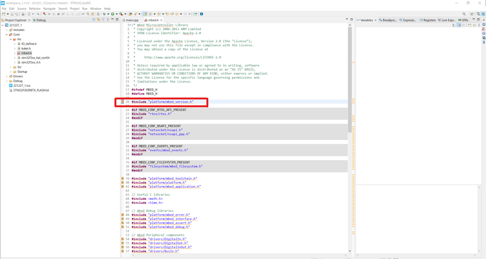

Thank you for your reply. I moved the header file to Core/Inc as you suggested and imported the mbed.h in the mbed-os you attached. Thanks to that, the error in main.cpp disappeared, but the next error was in a new header file declared in the imported mbed.h. I have confirmed that that header file is also in the mbed-os library that Rim attached, but I don't know which folder to put it in.
I tried creating a new folder called "platform" and putting the mbed_version.h into it, but that did not resolve the error. I know it is probably wrong to import the files one by one as I am doing, but I don't know how to import the libraries all at once. Thank you again and again for your help, but I would appreciate it if you could let me know.
