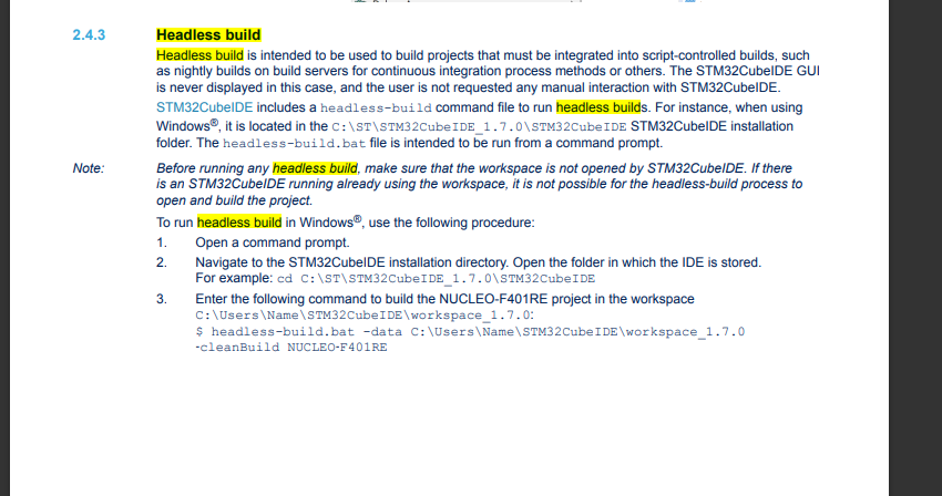

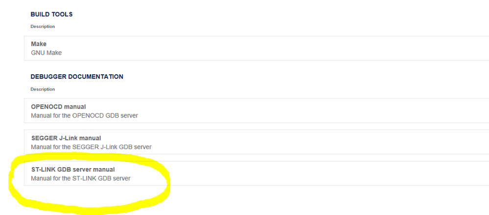

Wijeden RHIMI
 Hello@ VNaga.2,
Could you please check those stuffs :
  1. Read about headless build user guide
  2. Read GDB manual on using python for scripting debug
  3. You could find this two manuals in the help info center
  4. What do you mean with T2?
We need those answers to help you and solve your issue !
Wijdene,
VNaga.2
Hi @Wijeden RHIMI​ ,
Please point me to the help info center to find the user guides. I could just find the normal STMCudeIDE user guide.
I need to find the GDB user guides as well as the headless user guides.
Wijeden RHIMI
Hello@VNaga.2,
  1. headless build : go to  help ->info center->2.4.3
  2. GDB server manual: go to help ->info center->STL_LINK GDB server manual
Maybe those two screenshots bellow could help you :
Don't hesitate to ask any additional questions .
