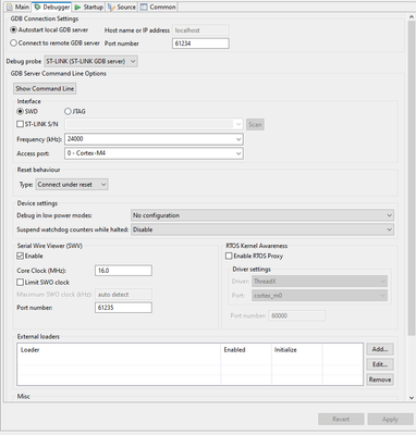

I'm using the NUCLEO-L433RC-P board for the first time. I made a simple code for making a LED blink just to make the card output anything yet I keep getting two error messages. Precisely "Failed to execute MI command: target remote localhost:61234" and an error message in the console "Error in initializing ST-LINK device. Reason: No device found on target". How can i fix this? Do i need any additional software/drivers to run the nucleo board?

Try erasing the flash using STM32Cubeporgrammer, and make sure to activate the gdb server log in the "Debugger" tab of your debug configuration, this may helped you.

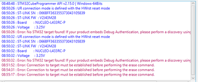

Hi, again! I tried doing a full chip erase but then i got another error message "Connection to target must be established before performing the erase command". I find this very weird since the log clearly shows that it made contact with the chip.
I fulfilled the other suggestions you suggested.

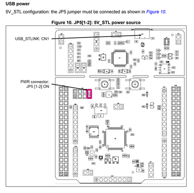

PS: ensure that the JP5 is connected as follow:
Best Regards.

look at the config of the debug ->

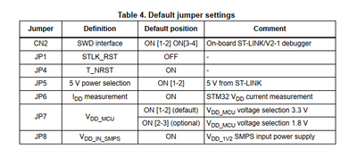

Are you supplying the board via USB? Then try connecting a powered USB hub in between. Sometimes, for example, the power of a USB port in a laptop is not sufficient to supply the board safely.
Are the jumpers on the board set correctly? JP6 (IDD), JP8, CN2
