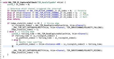

This is the code i am using to pick up input from RC receiver to then change pwm values, but there seems to be a problem. PWM's are unresponsive to RC receiver which is connected to timer 2 channels. Is the given code correct? could it be that HAL_Delay is causing problems? I would appreciate any feedback, ive spent too much time trying to figure out the issue.

What if you change batteries into the transmitter thing? Just guessing.
Sonzaye
The transmitter works perfectly fine actually, the problem is that i think ic_width stays empty, i cant check too because the ports for uart 2 are being used for timer and there are no other 5v resistant ports i can put the timer on.
