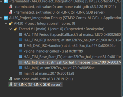

SDRAM is configured with TIM6 as a tick source.
While I am using GDB this interrupt continuously is interrupting the debug flow.
How do we disable such interrupts in stm32cubeide ?
This interrupt is continuously hogging gdb.
2022-12-05 11:14 PM
These stack gets called repetitively and does not let me debug.

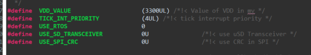

If I reduce the priority of the ticks then HAL_Delay does not work.
I am in a fix here dont know what to do ?
I have changed the tick priority also as shown in the figure.

There is no ready to check box in STM32CubeIDE to disable such interrupts.
So you need to do it in code or as GDB run commands :
#ifdef DEBUG
__HAL_DBGMCU_FREEZE_TIM6();
#endif
Have a look at: xyz_hal.h file depending on your STM32 product !

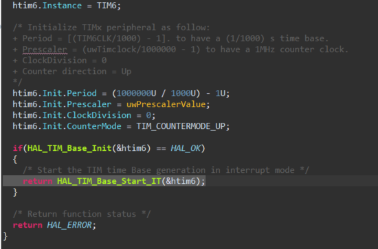

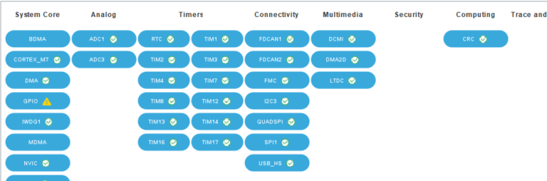

And the most important thing is that I have not configured the TIM6 manually or by cubemx. It was always used in the background by SDRAM. Even in cubemx the TIM6 appears grayed out
2022-12-06 10:32 AM

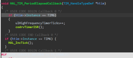

So TIM6 is the SDRAM clock AND the tick clock? And is the interrupt period really 1ms (as it kinda looks like it should be from the code you posted). Is the TIM6 clock really 1MHz as that calculation presumes? And it seems strange to me to use a 1ms timer to increment a "high frequency tick" variable (1ms isn't very "high freq" in my book).

I feel like TIM6 being that clock but not something we explicitly configured. When we go to stm32cubemx it is grayed out.
