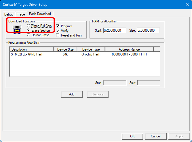

Keil (among others) allows the choice of whether to do a full or partial erase before programming:
Is it possible to do that in STM32CubeIDE ?
If so, how ?
Solved! Go to Solution.

Yes, I know that.
The question is how to make the download part do just a partial erase - instead of a full erase.
@Kraal wrote:As long as you don't have an external memory chip that requires an external loader, it does happen automagically.
But what it does "automagically" includes a full chip erase - the question is how to configure that.
We'd got as far as how to stop the automatic download, and how to set up a custom download - which could do the partial erase.
The next step would be to get that integrated again into a single step. You had suggested the 'Launch Group' - that does appear to exist in STM32CubeIDE, but how to use it?

Using Flash for non-volatile data storage (EEPROM emulation) - where you want to be able to down load new firmware without erasing the NV data.
‎2024-07-05 2:09 AM - edited ‎2024-07-05 2:10 AM
IDE work this way erase only code linker parts. I use this daily
‎2024-07-05 2:24 AM - edited ‎2024-10-23 4:05 AM
Not in my experience - it erased everything.
Correction: it doesn't - see:
‎2024-07-05 2:38 AM
No i repeat erased is all you config in linker file. Normal only used parts.
Show your log, LD...
