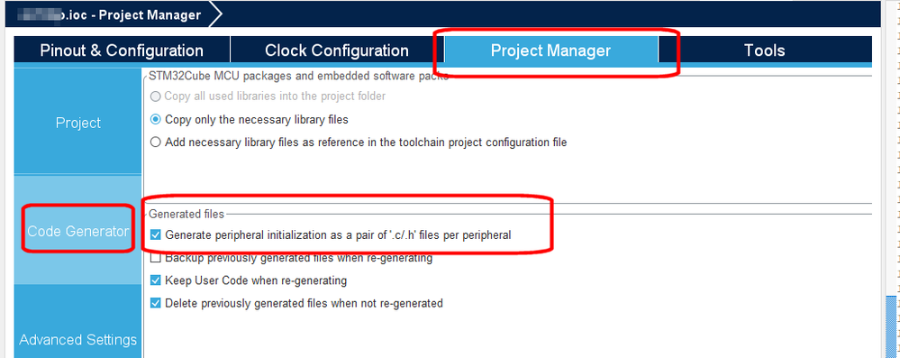

@EvO wrote:
the issue we are running into is that the integration of all hardware initialisation in the main.c file is different from the existing code: libraries with hardware interaction have all platform-specific code in separate c/h files
You can configure CubeMX to generate separate .c/.h files:

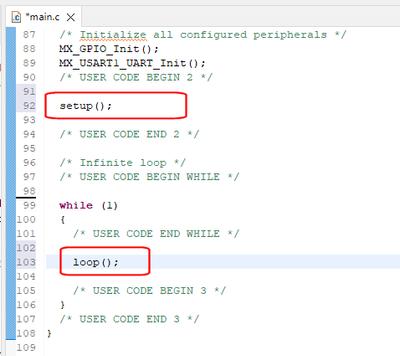

If you're familiar with the Arduino setup() and loop() structure for your user code, that can easily be achieved in the Cube-generated structure as:
That way, you can leave all the generated code alone - much as you never see Arduino's main() - and just work in your own files with your setup() and loop() functions ...

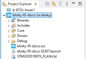

Andrew Neil
The standard project structure that CubeIDE generates is:
  • Binaries contains the generated project binary - usually a .elf file
  • Includes is auto-generated
  • Core contains your project-specific generated source - including the main() function in main.c
  • Drivers contains the standard HAL drivers
  • Debug contains various intermediate build output
I would create a separate folder for my user code - at the same level as Core.
But you can structure your projects entirely as you wish.
