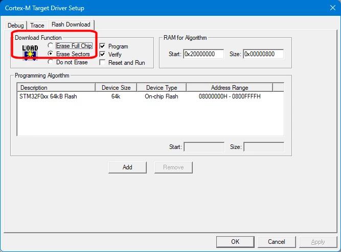

Keil (among others) allows the choice of whether to do a full or partial erase before programming:
Is it possible to do that in STM32CubeIDE ?
If so, how ?

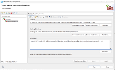

    I don't think there is a nice GUI window as in Keil, I'm using the external tool configuration and depending on the argument you specify it can do either mass erase or only needed sectors:
    For the sectors needed only, the argument is:
    -c port=SWD mode=UR -d ${workspace_loc}\${project_name}\${config_name:${project_name}}\${project_name}.elf -v -rst
    For mass erase instead:
    -c port=SWD mode=UR -e all -d ${workspace_loc}\${project_name}\${config_name:${project_name}}\${project_name}.elf -v -rst
    You can even skip the flash erase, or only some sectors. Everything is explained in the STM32_Programmer_CLI help.

    Thanks for that.
    So is that all I need to do, or does it also need some reference to the "external tool" to be added/modified elsewhere?

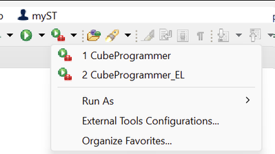

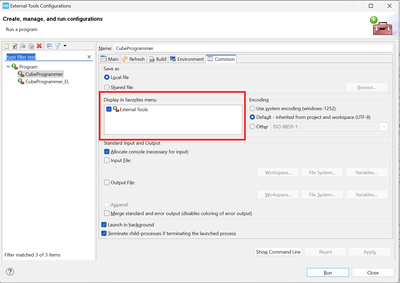

    Senior III
    June 7, 2024
    From the external tool configuration, the last tab "Common" there is a checkbox under "Display in favorites menu" that you should check (red box below) :
    Your configurations will then show in the main menu in the IDE :
    Note that you don't need to develop the drop down menu if you always use the same configuration, you can directly click on "Play_toolbox" icon (if you hover over it, the text shall say "use latest tool" or something like so).
    Warning: in my case, I have to select the project I want to flash in the project pane for the tool to work OK. Otherwise it fails to convert ${workspace_loc}\${project_name}\${config_name:${project_name}}\${project_name}.elf into something meaningful and will comply.
    Semer CHERNI
    July 4, 2024
    Hello @Andrew Neil
    This option is not available at this stage using STM32CubeIDE. However, plan to integrate similar feature in the tool.
    (113782: this is an internal ticket number).
    KR,
    Semer.
