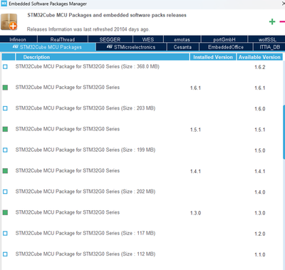

Hello, I'm having an issue with the STM32CubeIDE configuration.
Due to company policy, my development PC does not have internet access, so I need to set up STM32CubeIDE offline.

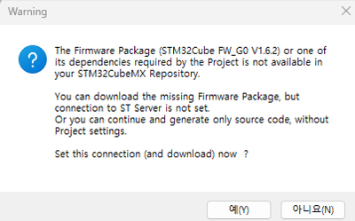

So, even though I installed the relevant STM32Cube for G0 series, I’m getting a “missing dependencies” error.
Why is it happening? What else do I need to install to resolve this issue?
Also, is there a way to check which dependencies are missing?

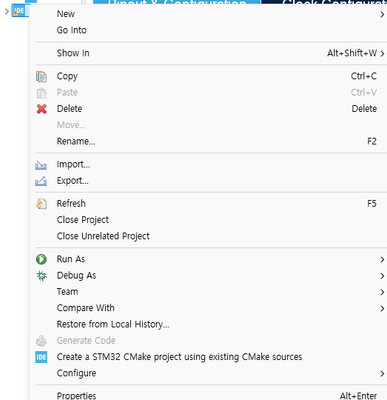

-> I cannot generate code from IOC because some dependencies are missing.

I followed the instructions from that link, but there wasn’t much progress.
Here are the results I found after further investigation:
  1. If I only download and install version 1.X.0 (without applying any patches), then create a new project using the MCU selector while choosing 1.X.0 as the Cube version, the project is created successfully.
  2. If I apply a patch, the problem persists even when selecting the correct version (in some series the patch applies properly, but usually the issue occurs).
  3. Even with only version 1.X.0 installed, if I create a project through the Board selector, the problem can occur as well (depending on the board).
