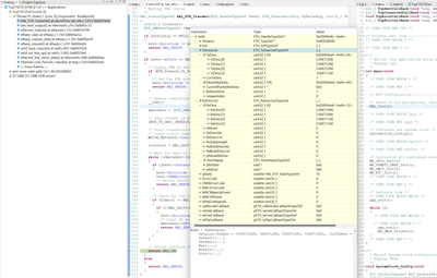

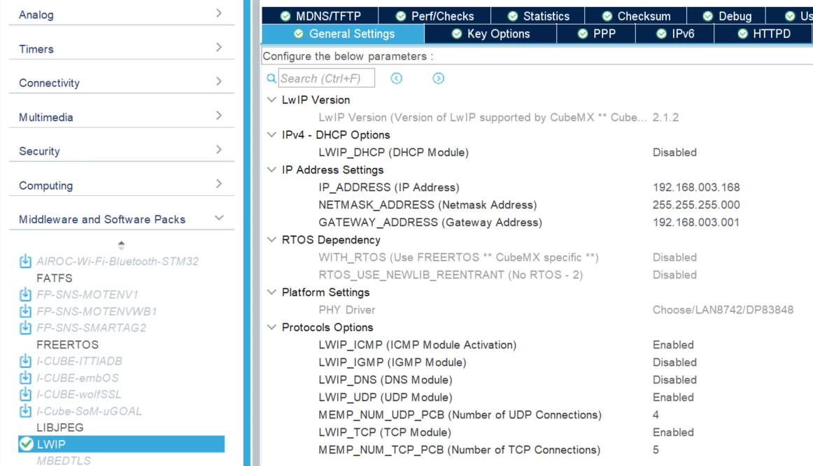

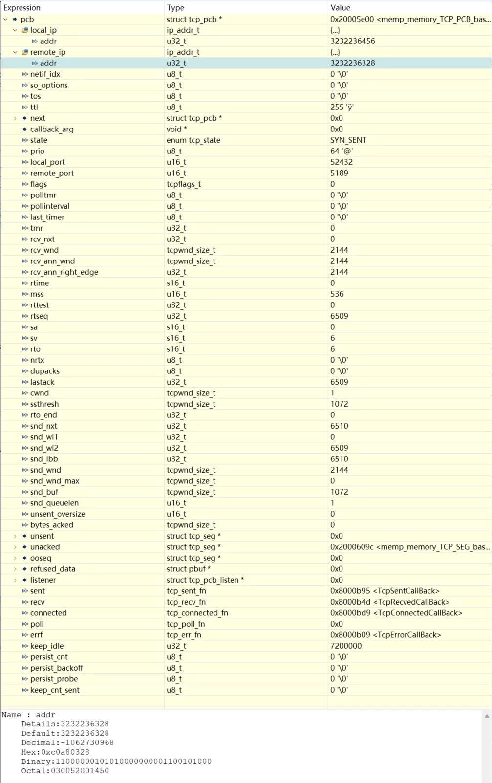

I have configured an ethernet application with LWIP and without OS using RAW API, the connection to a server running on a net assistant tool keeps aborting after 19 seconds of running.
With DHCP disabled, the application's ip address is configured to 192.168.3.168, while the server is running with ip address of 192.168.3.40 and port of 5189. The pings to the both ip addresses are OK, the server can be connected from another PC with ip address of 192.168.3.127.
The execution sequence of the code is as below:
tcp_err(pcb, TcpErrorCallBack);
tcp_sent(pcb, TcpSentCallBack);
tcp_recv(pcb, TcpRecvedCallBack);
tcp_poll(pcb, TcpPollCallBack, 10);
tcp_bind(pcb, &localAddr, 0);
err_t err = tcp_connect(pcb, &remoteAddr, remotePort, TcpConnectedCallBack);

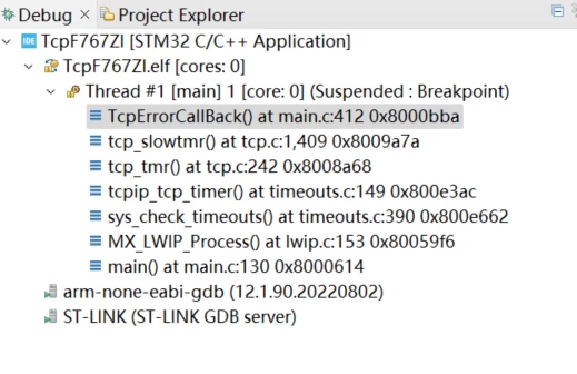

The callback function TcpConnectedCallBack() never gets called, and the application has never connected to the server.  tcp_poll() is used to execute tcp_connect() every 5 seconds. After the first execution of tcp_connect, all other executions of tcp_connect returns -10 (Conn already established). Sometimes, the first execution of tcp_connect returns -4 (Routing problem). Each time when the first execution of tcp_connect returns ERR_OK,the TcpErrorCallBack gets called with error code of -13(Connection aborted) 19 seconds after its running with following call stack trace:

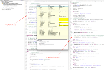

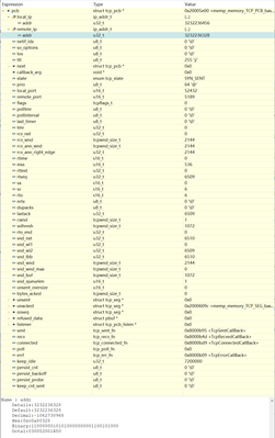

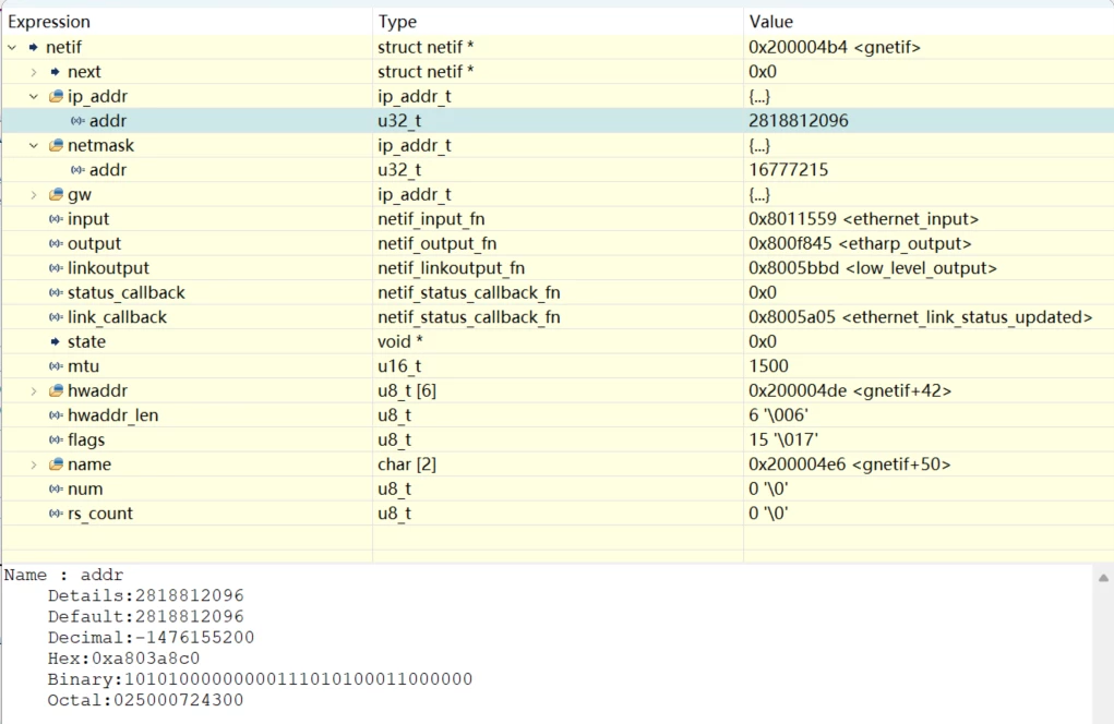

The tcp_pcb used for tcp_connect has the following contents after the execution of tcp_connect:

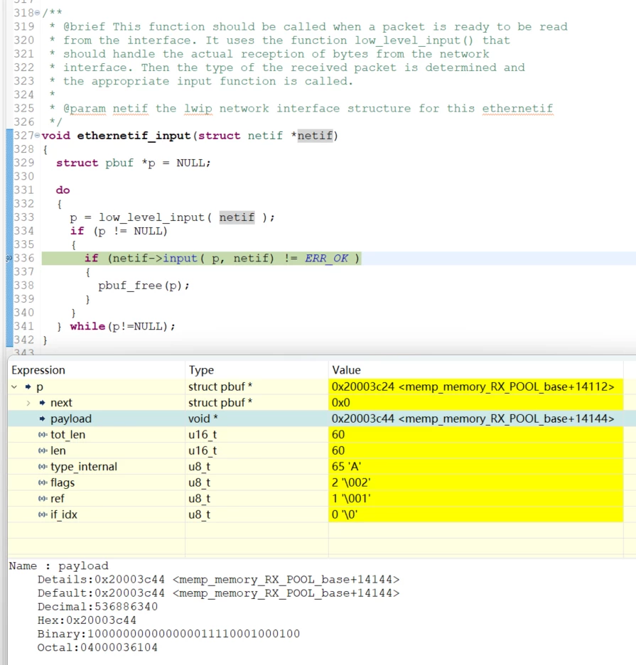

When tracking down the execution of tcp_connect, I got this:

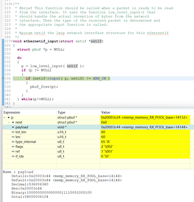

It seems there are incoming data packets:
Having done some experiments, I found whether or not I use tcp_poll or tcp_bind, they all do not make difference.
The main.c which includes all the application code attached. The ioc file is also attached.
After 10 hours debugging, I am nearly desperate about this, so please help!

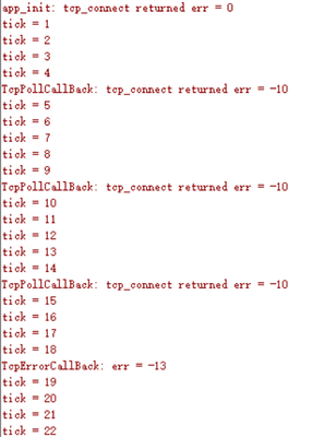

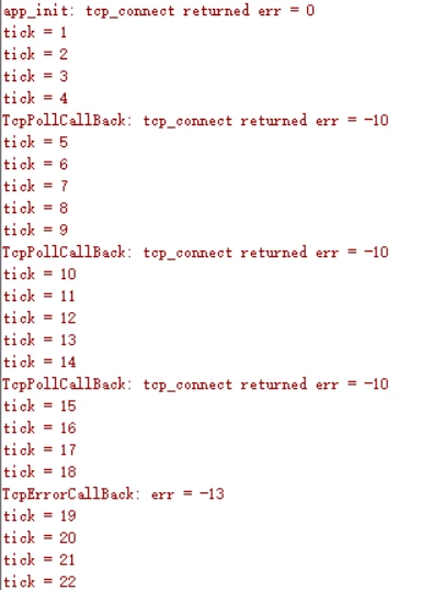

The typical print of the execution process:
The ticks are the elapsetime in second since the application starts running.

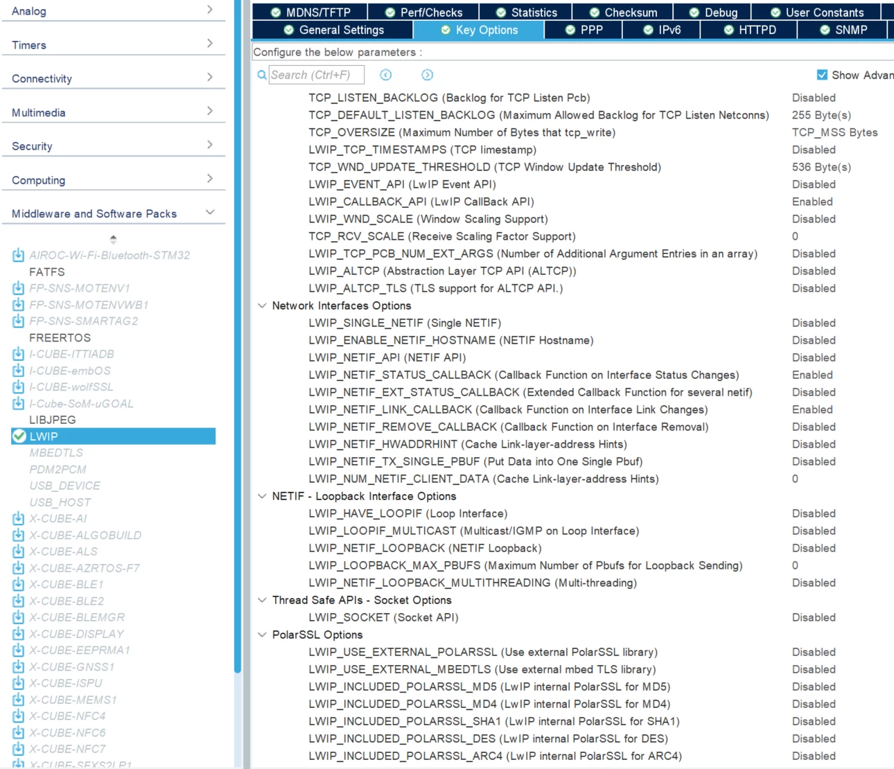

I am working on LwIP on a STM32F767 without an OS as well.
I am trying to use UDP.  I'm still working on it.  Nothing to report yet.  Shouldn't be long though.
I would like to use LwIP sockets, because I have used them successfully on other platforms.
Could you do me a favor ?  Could you go to Inc/lwipopts.h and change LWIP_SOCKET from 0 to 1 and try to build it ?  Mine has about 20 build errors.  What happens when you try to build with LWIP_SOCKET set to 1 ?
I'll have a look at your code and post back in a bit.

I think you are not supposed to do it manually, and we can only use Raw API without OS. My lwlp.c is attached.

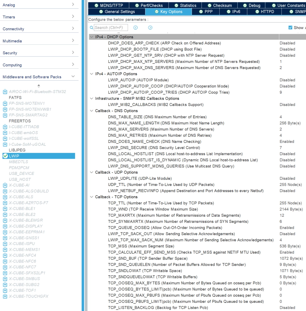

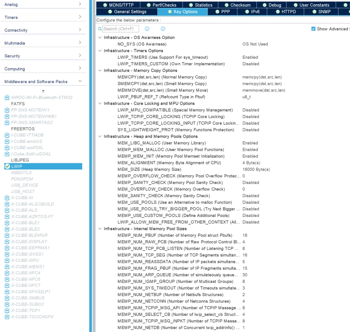

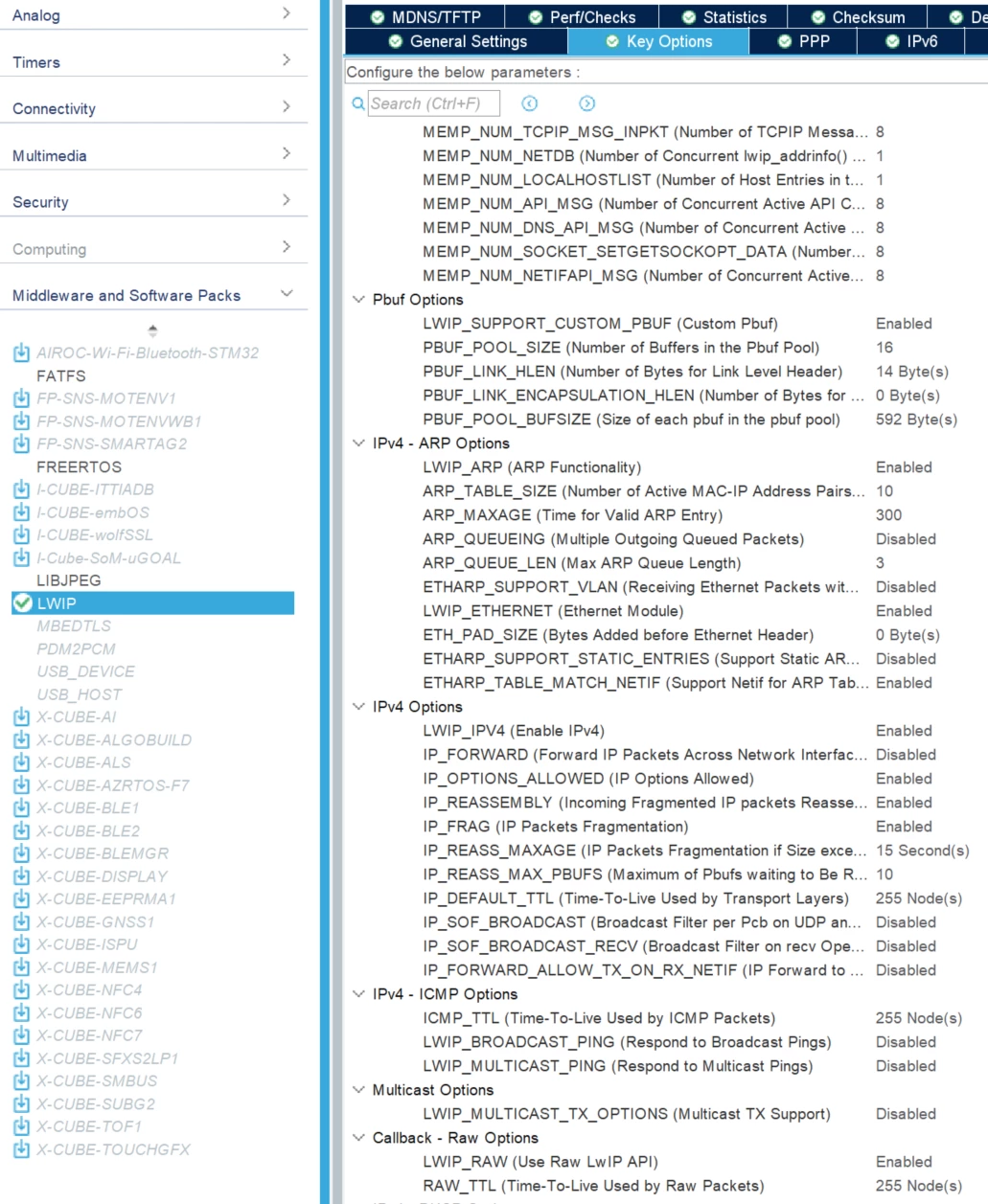

After enabling all the TCP debug options in LWLP's Key Options configuration, I managed to get the debug messages at runtime, please see attached files. tcp_debug_1.log is for running LWIP_TCP APIs and  tcp_debug_2.log is for running after enabling memory relevant LWIP options (i.e. MEMP_MEM_MALLOC etc.). The major difference between the two runnings is that IP address of 192.168.31.1 dissapears along with the following debug message:
ethernet_input: dest:0hx:0hx:0hx:0hx:0hx:0hx, src:0hx:0hx:0hx:0hx:0hx:0hx, type:ff
pbuf_remove_header: old 0x20002030 new 0x2000203e (14)
etharp_update_arp_entry: 192.168.31.1 - d4:da:21:6b:3f:47
etharp_find_entry: found empty entry 1
etharp_find_entry: no empty entry found and not allowed to recycle
etharp_input: incoming ARP request
etharp_input: ARP request was not for us.
Above message appears many times in tcp_debug_1.log while in tcp_debug_2.log the following messages are frequently seen:
pbuf_remove_header: old 0x20001800 new 0x2000180e (14)
etharp_update_arp_entry: 192.168.3.1 - c0:d1:93:da:6a:f4
etharp_find_entry: found matching entry 0
etharp_update_arp_entry: updating stable entry 0

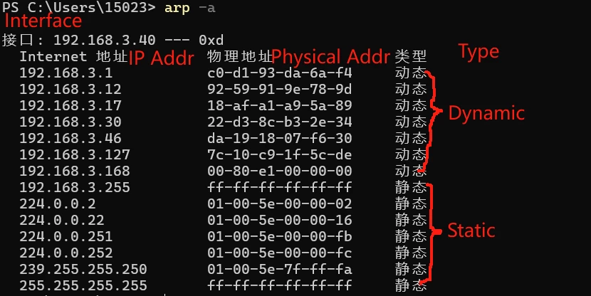

However, the IP address of 192.168.31.1 seems non-existent:
192.168.3.40 is the IP address of the server created by the socket tool. The application didn't send out any data within the while(1) loop.

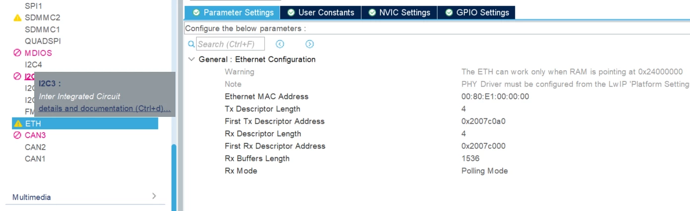

Ethernet global Interrupt is NOT enabled. And didn't change the GPIO Settings of the Nucleo board. LAN8742 is chosen.
In the Ethernet Configuration for ETH, there is a warning:
"The ETH can work only when RAM is pointing at 0x24000000"
I don't know what to do to avoid any potential problems because of this warning. I tried to change the First Tx Descriptor Address and First Rx Descriptor Address (just under the warning) from 0x2007c0a0 and 0x2007c000 to 0x2407c0a0 and 0x2407c000, but CubeMX does not allow me to modify them.
