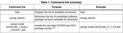

The manuals suggest using the following commands to download and install FW packages:
I've placed those commands in a script
swmgr install stm32cube_f4_1.28.0 ask
exit
and executed the scrip via PowerShell:
& "$env:STM32CubeMX_PATH\jre\bin\java" -jar "$env:STM32CubeMX_PATH\STM32CubeMX.exe" -q .\myscript

The login command appears to be unsupported because it's execution results in the help command output being displayed.  Odd, that login is not supported, the previous swmgr command specifically calls it out as necessary (as I showed above) and it's also described in the manual.
Can someone help me understand what I'm actually supposed to do here to download packages? Seems the command line has issues.

It seems the swmgr install command is functionally useless anyway as according to the usage I can only (deny|ask) the package license.  There is no accept option?
Usage:
swmgr swmgr install <full_cmsispack_name | full_firmware_name | full_filepath> <licence_mode (deny|ask)>: install specified Cmsis packname or Cube Firmware with se
lected license accept mode.
ask - negates the entire concept of command line where you don't want to interact with a UI as it pops up the license acceptance dialog and freezes for user input.
deny - downloads the package (yes, goes through the entire download) and then tosses it out because you automatically deny the license. So net is a NOOP where you downloaded an 800Mb file. Seriously, who actually authored this API and what possible use case does this represent?
