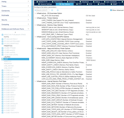

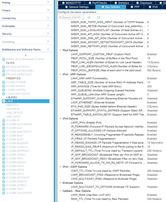

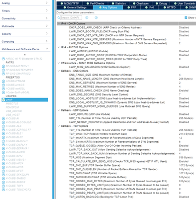

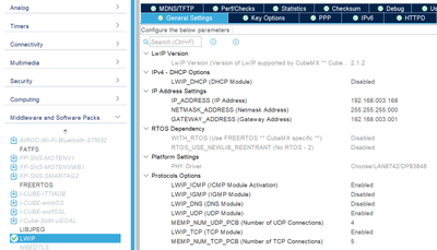

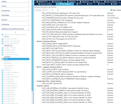

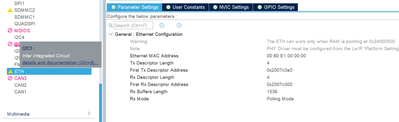

"Today, I checked the code for initialization and that in while(1) loop in main.c against two Cube examples targeted on different boards"   Which Cube examples ?   Were these examples FreeRTOS or no OS ?
"I did a reset on LWIP configuration, then disabled DHCP, chose Lan8742 in Platform Settings, enabled LWIP_RAW APIs, and changed nothing else, I got the same result: the server running in a socket tool did not show any new connection, and the F767's Tcp connection was aborted after 19 seconds."

After enabling all the TCP debug options in LWLP's Key Options configuration, I managed to get the debug messages at runtime, please see attached files. tcp_debug_1.log is for running LWIP_TCP APIs and  tcp_debug_2.log is for running after enabling memory relevant LWIP options (i.e. MEMP_MEM_MALLOC etc.). The major difference between the two runnings is that IP address of 192.168.31.1 dissapears along with the following debug message:

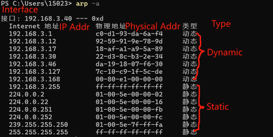

However, the IP address of 192.168.31.1 seems non-existent:
192.168.3.40 is the IP address of the server created by the socket tool. The application didn't send out any data within the while(1) loop.

Then I set the min heap size from 0x400 to 0x4000, and min stack size from 0x200 to 0x800, running the application again and I didn't see the difference. Replace raw_send() with raw_sendto() (raw_connect() is not called in this case), no incoming message gets printed out in the server side.

Ethernet global Interrupt is NOT enabled. And didn't change the GPIO Settings of the Nucleo board. LAN8742 is chosen.
In the Ethernet Configuration for ETH, there is a warning:
"The ETH can work only when RAM is pointing at 0x24000000"
I don't know what to do to avoid any potential problems because of this warning. I tried to change the First Tx Descriptor Address and First Rx Descriptor Address (just under the warning) from 0x2007c0a0 and 0x2007c000 to 0x2407c0a0 and 0x2407c000, but CubeMX does not allow me to modify them.
