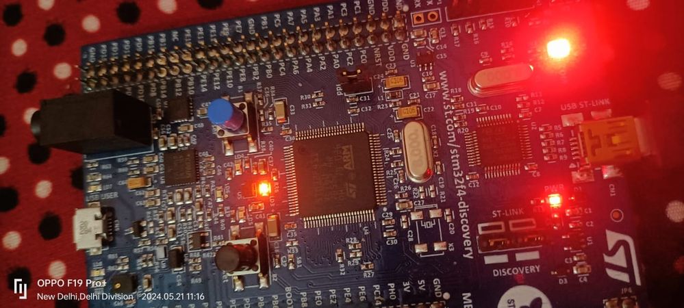

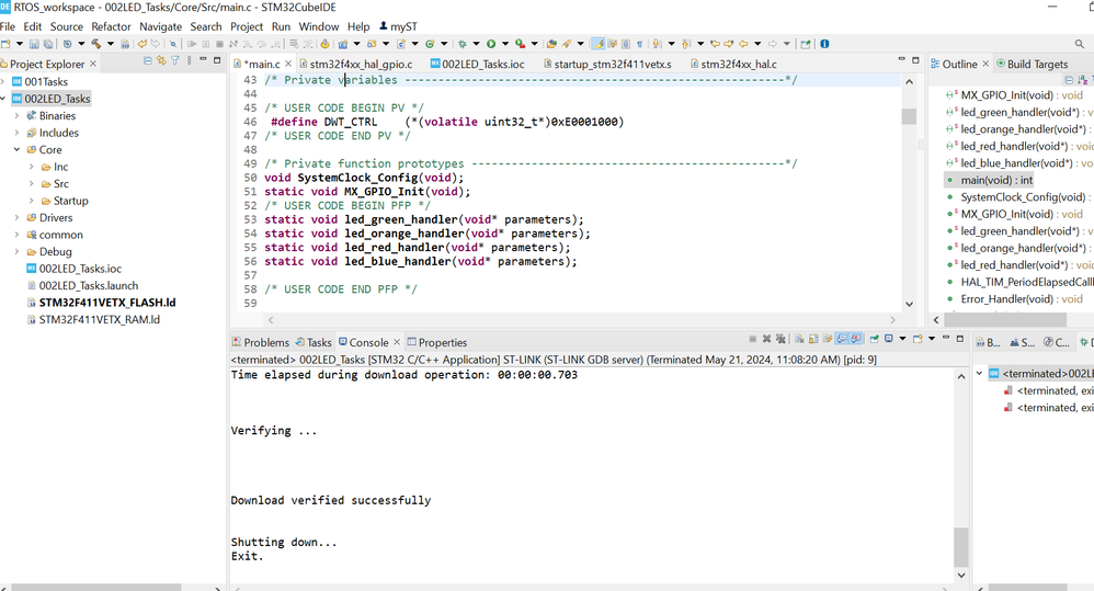

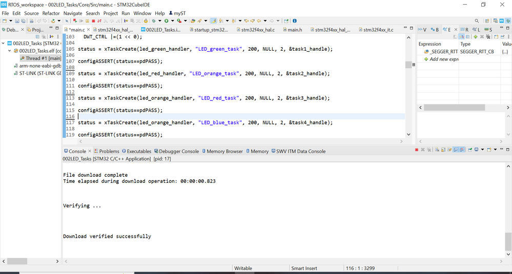

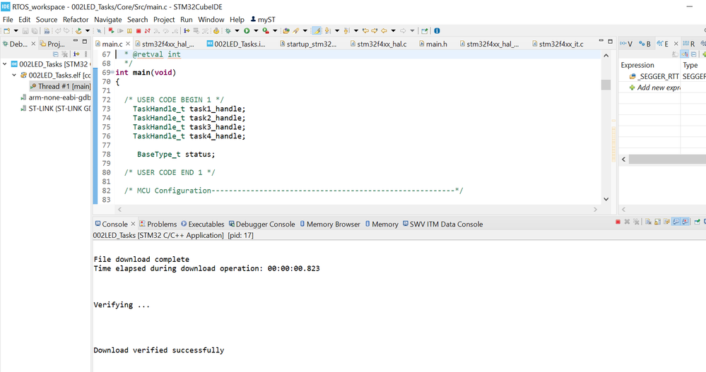

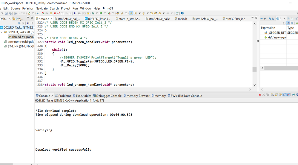

I built a project in STM32F411E-DISC . project is built successfully and also  when we debugged no issue is found ,but after debugging only ORANGE LED is toggling rest 3 LED is not toggling . kindly help me to resolve this issue .kindly  find for code and microcontroller.WhatsApp Image 2024-05-21 at 11.16.40 AM.jpegCapture-3.PNGCapture-2.PNGCapture-1.PNGCapture.PNG

Apparently, you are running multiple tasks and using the HAL_Delay() function.
This creates a problem. The solution is to change the Time Base from sysTick to another Timer.
The SysTick is a special timer in most ARM processors that’s generally reserved for operating system purposes. By default, SysTick will be used for things like HAL_Delay() and HAL_GetTick(). As a result, the STM32 HAL framework gives SysTick a very high priority. However, FreeRTOS needs SysTick for its scheduler, and it requires SysTick to be a much lower priority. Therefore, a quick workaround is to use a Timer as a Time-base source in the cases of freeRTOS.

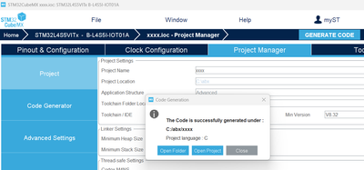

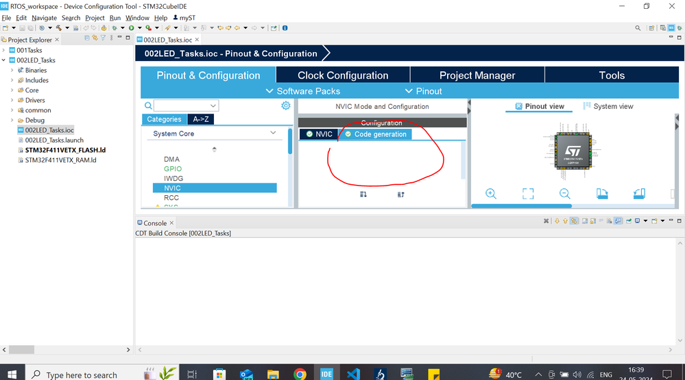

why  code generation section is blank . i build 2 project but still in both project code generation section is blink , how to resolve this issue Capture-4.PNG
refer to the snapshot, and Click the Right-Top Corner to generate the Code.
The one you have circled up is to setup the parameters.
