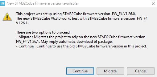

If IDE 1.6.1 I'm getting 1.26.0 FW pack usage.
Opening now such project based on IDE 1.7.0 I'm getting dedicated popup dialog asking me if I want to remain on 1.26.0 FW package or to migrate to 1.26.1 new one.
0693W00000D0zrIQAR.jpgBoth migrate or continue paths are working fine on my side

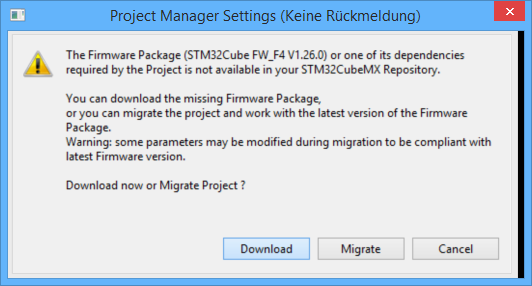

But I just checked how the STM32F407 project behaves and for me I'm stuck again
0693W00000D0zwmQAB.pngCould it be related to Windows 8.1 or the firewall/security suite?
I'm Win10 based.
If IDE 1.7.0 could you have a try to do "File > New > STM32 Project from an existing STM32CubeMX configuration file (.ioc)" ?
MWiel.1
that seems to work but shortly before the above dialog, I see a dialog pop up with the CubeIDE/CubeMX Icon.
Possibly german language issue ? See such win7 post about STM32CubeIDE generates high CPU load (Win7)
Sounds moving to english is solving ... ?
