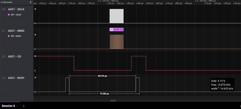

I've built a custom system using the STM32F733xx and an external ADC (TI ADS8588S) connected over SPI. I have verified that the system works consistently using the STM32 HAL L0_V1.2.8 when transferring data via the blocking/polling method. However, when I configure the SPI to run non-blocking with a linked DMA I can only get one full transfer to complete. Successive transfers fail to produce SCLK as shown below:

The issue is that HAL_SPI_TransmitReceive_DMA call errors out on the 2nd call with HAL_BUSY because hspi->State is HAL_SPI_STATE_BUSY_TX_RX. I thought the root cause was related to SPI Tx sending dummy data and asserting the DMA_FLAG_FEIF3_7 flag but clearing this didn't help.
I cannot see how to reset the SPI1 DMA so that successive transfers can happen. I have suspicions on the status flags (TXE, RXNE) but I cannot see what is wrong.
Thank you in advance.
Grundyoso

Typo? Or are you using L0 libraries on an F7 device?
Looking at the return value from HAL_SPI_TransmitReceive_DMA when it fails would probably shed some light.
Perhaps a typo... I'm using the STM32F7xx_HAL_Driver that was included with the STM32CubeIDE_1.4.0 ... I thought this was V1.2.8 of the HAL as listed in the GitHub repo https://github.com/STMicroelectronics/STM32CubeF7
The return value of the HAL_SPI_TransmitReceive_DMA when it fails is errorcode HAL_BUSY ... I think the HAL is stuck in the HAL_BUSY state because the SPI Tx is sending dummy data and perhaps doesn't get a signal that the transfer was completed (since the MOSI line isn't active)?? The only thing that puzzles me is what this is not an issue when I use HAL_SPI_TransmitReceive, which works fine.
Any ideas what could be going on? I've been stuck at this for a few days now :(
Looks like you've deleted the required HAL_DMA_IRQHandler call from within DMA2_Stream2_IRQHandler. You should only be adding code between USER BEGIN / USER END sections, and not deleting stuff outside of that.
You shouldn't be clearing flags, the HAL library does that and clearing them yourself will prevent the code from doing its thing.
If you want to access the end of the transfer, consider implementing HAL_SPI_TxRxCpltCallback instead to de-assert the CS line.
HAL_SPI_TransmitReceive works because it's a blocking call and doesn't need an interrupt to set the state back to ready.
(I corrected some typos in this post which may have been confusing in the original reply. Replying to this so you get another notification.)
Grundyoso
I was able to get this to work (finally). There were several issues with my code, the most obvious being that I wasn't following the HAL design pattern so it's state wasn't properly being managed. Once I added " HAL_DMA_IRQHandler(hspi1.hdmarx);" in place of the code I had in "void DMA2_Stream2_IRQHandler(void)" and moved that code to "HAL_SPI_TxRxCpltCallback()" then things started working. I was daisy chaining the DMA transfers which was causing a problem as well so had to use a TIMER to schedule each subsequent transfer. Once all that was set, things worked as expected.
