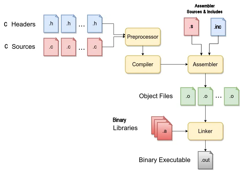

On the distinction between source and binary:
Traditionally, "Library" was used to mean a pre-built binary library.
Nowadays, people also commonly speak of source-code libraries.
https://www.stackzero.net/compilation-process-in-c/

Yes, one of the things that the Arduino IDE "hides" from you is these details behind adding a library.
Note that there are Arduino cores for STM32s; eg,
https://github.com/stm32duino/Arduino_Core_STM32
https://www.arduino.cc/reference/en/libraries/stm32duino-examples/
So using STM32 doesn't necessarily preclude continuing to use the Arduino IDE...
