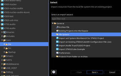

So you have to "import" it : right click on the directory, you want it to be ->
next -> browse the source , select what want - ready.
This for every source .c or .h (or group of ..) , then the IDE got it.

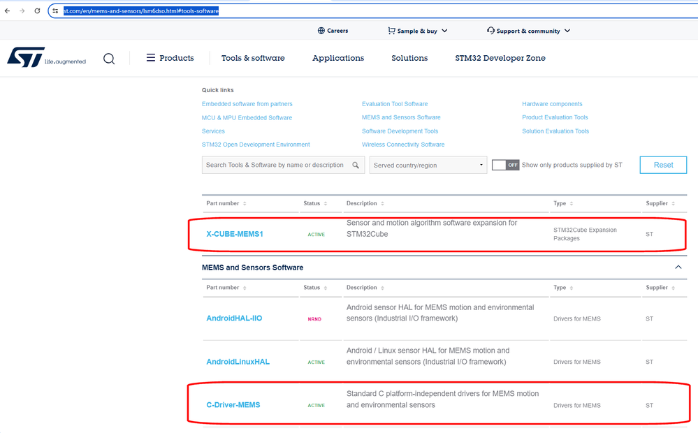

You also need something which contains the actual implementations of those functions - either as source code, or a pre-built binary.
I suggest you look at the X-CUBE-MEMS1 and/or C-Driver-MEMS software packs:
https://www.st.com/en/mems-and-sensors/lsm6dso.html#tools-software
