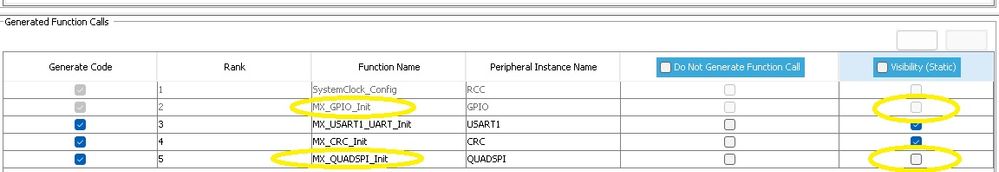

rflamino
Guys, dont forget to uncheck those before generating code; for removing static declaration from the external call functions. Those for example, refer to attached picture.
