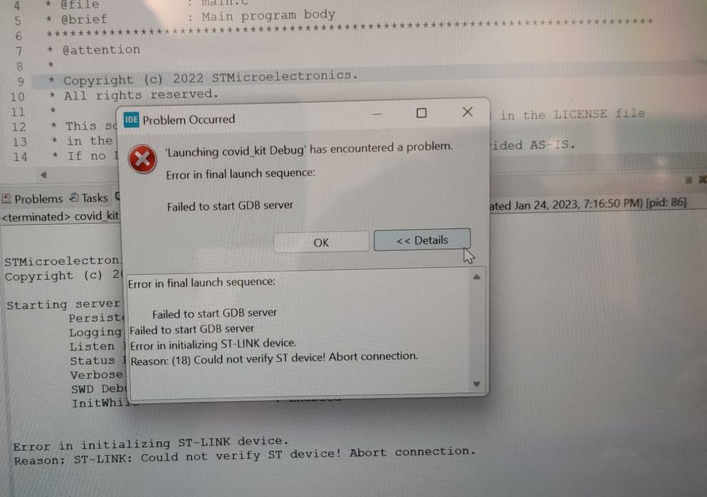

I have tested my code in blue pill and now have made my custom pcb containing stm32f103c8t6. I am unable to program with my st link. The ettings on stm32cubeide are correct as the code gets uploaded in the bluepill. Do we have to set or reset the BOOT0.

So, you have an illegal ST-Link clone which ST does't want you to use (it still partially allows it, but slowly the policy is being tightened) and, very likely, you are trying to debug a STM32F103 clone, which violates the STM32CubeIDE license.

Do you have another ST-Link ? or better an original ST-Link?
Since your code is working on the blue pill, the issue may be related to the ST-LINK!
if not, you may need to reset the BOOT0 pin. This can be done by setting BOOT0 to ‘1’ while powering the board. This will set the board into the bootloader mode and allow you to use ST-Link to program the board.
Hope that helps!
Hi @Sarra.S​, thankyou for your reply,
I have tried both ie. using another original ST-link V2 and by resetting the BOOT0 pin. Still the code is not uploading...
Just to clarify- I am programming my stm32f103c8t6 based custom made pcb with ST-Link V2 via I2C (Vcc, Gnd, SWCLK, SWDIO).
in this case, Are these 4 pins enough to program the uc or is setting/ resetting of BOOT0/ BOOT1 pins required ?

What messages do you get while attempting to program the MCU? And what's your "original" ST-Link. If it has a pendrive-like metal case, then it's not original.

Sharing the screen shot of error that pops up.
Also, STMCubeProgrammer detects the ST Device with the same hardware setup.0693W00000Y921ZQAR.jpg
So, you are able to connect to the board using STM32CubeProgrammer but not with STM32CubeIDE!

Below attached is the error message i get.
And yes u r right, ST-link v2 i am using is not the original one then.0693W00000Y921ZQAR.jpg
yess u r right.
Have a look at this thread that suggests a solution that seems to work for several people.
