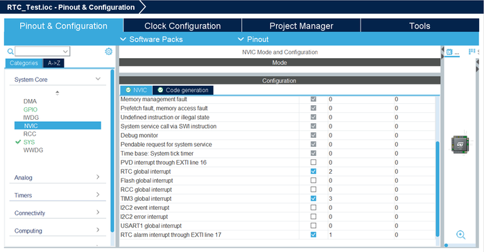

The interrupt priorities are set in the following order (from highest to lowest priority):
  1. SysTick interrupt.
  2. Alarm interrupt.
  3. Global RTC interrupt.
  4. Timer 3 interrupt.
I must clarify that the priority of the SysTick interrupt should be higher than any of the RTC interrupts since it is used as a time reference for calculating timeouts in various functions of the RTC module.
