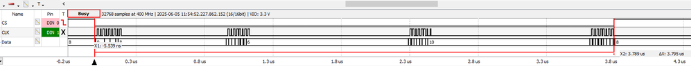

As result, I see by Logic Analyser the next picture:
The first burst of clocks corresponds to the transmission if Command, the 2nd - to the Data. The gap between two bursts  is about 0.76 mks in the case of using of HAL_QSPI_Transmit_IT and 1.5 mks in case of HAL_QSPI_Transmit which is somehow strange.

I have found, that if I set hqspi.Init.ClockPrescaler to relatively large value 200, then I do not see this gap by logic analyser. But it is always there at low ClockPrescaler values like 4-20. And I have in Clock Configuration that HCLK3  = 240MHz goes to QSPI.
Moreover, I ran a similar test in MBed OS - and the behavior was exactly the same!
Therefore, it seems that the problem is STM32H7 QSPI module hardware - it takes at least 0.8-1.6 mks to switch from Command to Data transmission. So the figures of the data transmission in the Indirect Mode at high speeds in STM's manuals are not correct. Or STM should provide some explanation how to do it without gaps...

I returned to this strange problem with delays in QSPI transmission. I succeeded to enable the I and D cache in my project - it was a problem with TCP+:  https://forums.freertos.org/t/freertos-tcp-stm32h743-dcache-doesnt-work/23167/10
But this do not help with QSPI. Even more - I tried to send as a data 12 bytes. Result is next:
I see that data is transmitted by 4-bytes chunks separated by similar delays as a Command. And this strange behaviour do not depend on hqspi.Init.FifoThreshold value - it can be 1 or 4 doesn't matter. All transmission takes 3.8 mks instead of 0.57 mks - this is awful!
