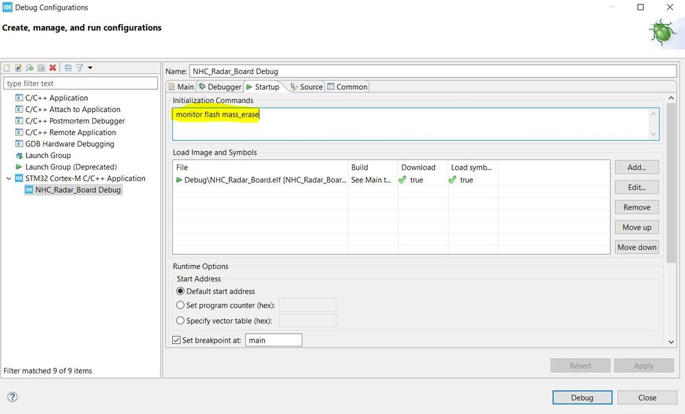

I use the STM32CubeIde and the Segger J-link program tool.
I've noticed that when reprogramming only the sectors where the program comes are reflashed.
Since I also use other secoters for data storage, would I also want to delete/clear these when reprogramming the mcu?
How can I set the STM32CubeIde environment to erase the entire flash before programming with the segger J link tool (debug/release)?

2021-11-06 10:18 AM
I think this works for a ST link debugger connection ; unfortunately not for a Segger Jlink?!
When adding "monitor flash mass_erase" to the debug configuration -> Initialization statup :

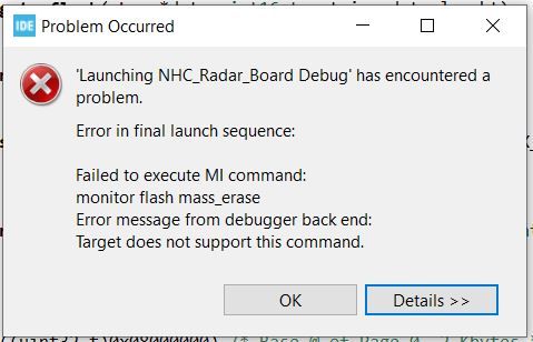

I get the following error :
Any suggestions?

2025-01-08 8:55 AM
Try "monitor flash erase" instead. This works for me here with Jlink 8.12 and CubeIDE 1.17.0 (at least when I issue the commands manually)
Markus
