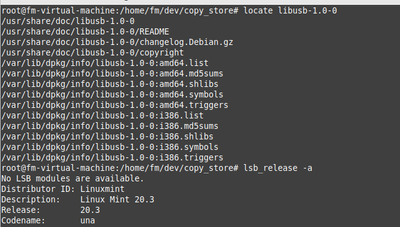

> Is it because the host is running arm64 vs the expected amd64 on the VM?
No both are not related.
One is the host platform (amd64), the other the target (arm64).
AFAIK Ubuntu 22.04 is a 64-bit only distribution.
An "uname -a" should contain something like "x86_64" in the output.
And checking the first package in my VM, it is present :
I suppose you did at least one apt-get update / apt-get upgrade / apt-get dist-upgrade  cycle, didn't you ?

> Yes, I'm defintely running all 64-bit hardware. My host is running Apple M3, so is a and running uname -m yields arm64: ...
So, it makes sense to me that the amd64 package doesn't work. Never been an Apple user.
If your Linux inside the VM returns "arm64", I suppose you have installed a "native" Ubuntu 22 for ARM.
Thus all the packages would need to be ARM, too. Although I suppose you know.
Insofar as Ubuntu ARM repositories and CubeIDE support, I'm out of my depth.
In theory, the M3 is able to emulate x86, code, not sure if and how this applies to your situation.
But this is a clue, I think:
> libxxx:amd64 but it is not installable
I would check why dpkg thinks it is "not installable".
