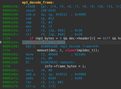

when this function ( mp3dec_decode_frame(..) ) is used, get hard fault. ok, but cannot debug , because no step into function is possible, hard fault is always next step.
Now the prerequisites : this function i used to decode MP3 in my H743 project, no problems.
then copied to this H563 project, but now using rtos Azure (because forced to use this by STM)…
and now : not working anymore, even cannot debug, what happens there, because first is : jump to hard fault.
So maybe the stack is in nirwana, but i cannot see (understand ARM assembler) anything, that leads me to solve the problem.
See , here is the debug at starting the function:
disassm shows here:
(i see no problem...) stack is in mem:
and this seem ok:
so: how to find the reason for this hard fault ?
next step ...hard fault :
cpu then:

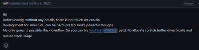

so had the idea: maybe i am not the first to get this problem with the mp3-decoder, look at "issues" on git ;
and i found a comment:
so it seems to need much room on stack - i set the thread to 24KB stack, just to check.
then : no hard fault and ThreadX stack statistics show now (!) : about 23K stack used !
But still i am puzzled, why the hard fault can be at the call of the function, without any step to the function?
I tried using the same function call to test , whether there is a problem with the parameters/stack usage and this worked without any problem. So more stack is only needed by the decoding and tables (what i removed for this test), that are called in the analyzing and decoding steps.
How can it "know" at the call, that this will call other functions needing to much stack later then ?

Indeed even your initial code allocates ~17 KB of stack space in that function:
sub.w sp, sp, #17280 ; 0x4380
If it is not done directly in the code of that function, it is a result of function inlining done by compiler optimization.

but still i dont understand: on single step, who generates hard fault at the first instruction , where just some pointers are pushed to the stack ?
and even the stack gets too big, it just would "kill" some other memory (for usb stack..) - so how or who calls hard fault here? is it the rtos ?

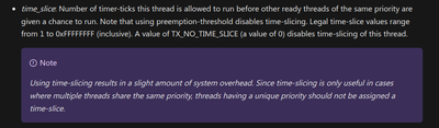

TreadX can use time-slice/task switching - just as initial setting is, it dont do it.
Thats why in first simple test it didnt work.
I had to read first how to set it:
https://learn.microsoft.com/en-us/azure/rtos/threadx/chapter4#tx_thread_create
