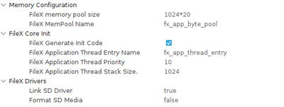

FileX   20KB pool   , 4K stack. exfat enable , MAX_CACHE_SIZE_NB_BIT 9 ; map_size 128;

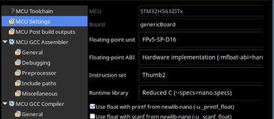

Is the floating-point coprocessor enabled?

Looks like it might depend on the double precision FPU-D of the H7. Perhaps use library from CM4F part or F74x core with FPU-S
should be...
...there was a problem with : on what cpu we are here ?

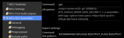

float seem used .
but at first the mp3-lib had some ARM64 setting found in defines...i dont know why.
i just put a "!" (=not) on this define, to get
#define HAVE_ARMV6 0
before it had aarch64 active.  Crazy, this was not in my H743 project (but i dont remember, whether i set some define there or modified a global define...afaik i didnt; it was set right and worked. )
now armv6->0 and so should be ok, in this respect.

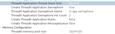

@HTD , right, i also had suspicions against Azure - stack, memory management - and increased values:
8K stack, 100K mem
but not in filex, because this seems (!!!) working fine.
still have 300K ram free, so i try with more mem for filex thread - as you suggest.

As @Tesla DeLorean said above, from disasm (vpush of double registers) it appears that the library uses double-precision FPU which is not available in Cortex M33/'H5. I'm not versed enough to tell if vpush of double is indeed dependent on presence of the double-precision FPU, but, just another question to the many: do you compile that library from sources, or does it come as a precompiled .a?
Also, I'm not sure the -fpu setting guarantees the FPU to be switched on. IIRC in the Cube infrastructure, compilation of the couple of instruction needed to switch it on depends on some specific preprocessor symbols to be present - see startup code or functions called from there for relevant details.
