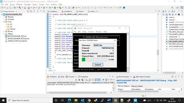

Thanks for your reply , based on the above examples i prepared one project for STM32L151RCT6 MCU and i loaded it.
passing the binary file from the Y modem Tera term , it is receiving half of the file and stopped shown bellow.
i tried the uart baud rate for both 9600 and 115200 both are showing same behaviour , i am not getting what is problem..
please help me for this .. it is needed for me.
consider the attached y modem function.

It is stopping as shown above

These are flash memory definitions
Mike_ST
Please, try with Teraterm version 4.85, just to check whether it works. I know that later Teraterm ymodem implementation has changed a bit.
You'll probably have to learn a bit about ymodem protocol too to see why it is stalling.
Thanks for reply , i tried with same version of Tera term what you suggested but not solved the issue..
is it related to flash programming ? or any address assigning?
