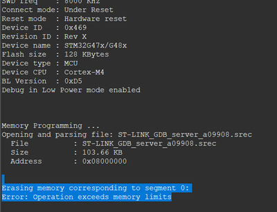

While flashing code in STM32G474VBT6, I am getting below error. After reinstalling cube ide and cube programmer, same error continues.
STMicroelectronics ST-LINK GDB server. Version 7.4.0
Copyright (c) 2023, STMicroelectronics. All rights reserved.
Starting server with the following options:
Persistent Mode : Disabled
Logging Level : 1
Listen Port Number : 61234
Status Refresh Delay : 15s
Verbose Mode : Disabled
SWD Debug : Enabled
InitWhile : Enabled
Waiting for debugger connection...
Debugger connected
Debugger connected
STM32CubeProgrammer v2.14.0
Log output file: C:\Users\NIKHIL~1\AppData\Local\Temp\STM32CubeProgrammer_a02888.log
ST-LINK SN : 68005200040000363036544E
ST-LINK FW : V2J42S7
Board : --
Voltage : 3.26V
SWD freq : 4000 KHz
Connect mode: Under Reset
Reset mode : Hardware reset
Device ID : 0x469
Revision ID : Rev X
Device name : STM32G47x/G48x
Flash size : 128 KBytes
Device type : MCU
Device CPU : Cortex-M4
BL Version : 0xD5
Debug in Low Power mode enabled
Memory Programming ...
Opening and parsing file: ST-LINK_GDB_server_a02888.srec
File : ST-LINK_GDB_server_a02888.srec
Address : 0x08000000
Error: Operation exceeds memory limits
Error: failed to erase memory
Encountered Error when opening C:\ST\STM32CubeIDE_1.13.1\STM32CubeIDE\plugins\com.st.stm32cube.ide.mcu.externaltools.cubeprogrammer.win32_2.1.0.202305091550\tools\bin\STM32_Programmer_CLI.exe.
Error in STM32CubeProgrammer
Shutting down...
Exit.
Can anyone help me to get solution?

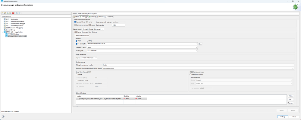

_kalpesh
Hey!
i faced same error when i was trying to write flash memory  for stm32
i changed debug configurations for that project.
need to change Reset Behaviour to None which comes under debugger tab of debug configurations.
i hope this resolves the error

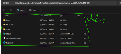

We found how to go around the problem :
The issue is with cubeProgrammer versions newer than 2.13.
If using a standalone cubeProgrammer newer than 2.13 and trying to flash an specific .elf file will result in Erasing memory segment 0 error.
When using  cubeProgrammer version 2.13 the thing flashes , no complaining.
So the problem here is cubeIDE version 1.12.1 comes with a cubeProgrammer v2.13 CLI plugin, this means flashing or debugging our project with cubeIDE 1.12.1 works, but the same thing with newer cubeIDE versions doesnt.

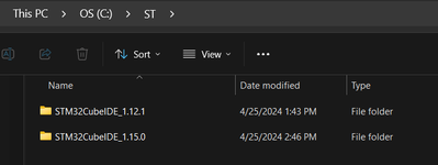

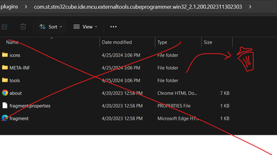

How to fix this, folder swapping plugins from two IDE versions, (disclaimer its ugly):
  1. Download both cubeIDE v1.12.1 and your newer IDE (1.15.0 in my case)Javier1_0-1714061942182.png
  2. Try (unsuccesfully) to flash or debug your code, at least one time ,with your newest IDE(mine is 1.15.0).
    If you dont do this the IDE will crash when trying to debug after the folder swap.
  3. Erase the contents of com.st.stm32cube.ide.mcu.externaltools.cubeprogrammer.win32_..................
  4. Copy the contents of the equivalent folder from cubeIDE v1.12.1
    com.st.stm32cube.ide.mcu.externaltools.cubeprogrammer.win32_2.0.600.202301161003
  5. Paste in your now empty cubeIDE 1.15.0 folder
  6. Enjoy
