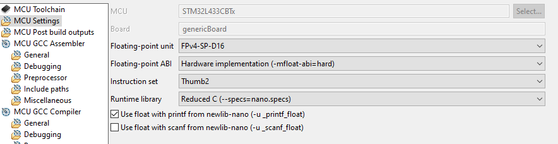

Both projects have the same setup as below:

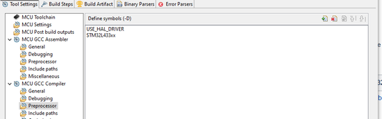

Preprocessor:
Link setup:

Thanks for your reply. Apart from the "DEBUG" in the PreProcessor tab within the compiler, how is this done?
Many thanks
Scott

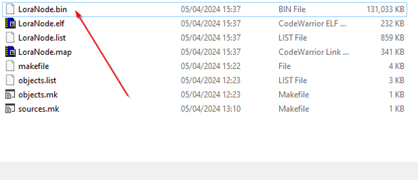

Thanks for your reply. In previous projects I use the the command:
arm-none-eabi-objcopy -S -O binary "Project.elf" "Project.bin"
to create the binary to go into the chip , but this time the bin file size is converted bin is 131,073KB , too big for the chip.
Regards
Scott
‎2024-04-05 7:33 AM
@SSmit.13 wrote:the bin file size is converted bin is 131,073KB
Really - 128 M bytes ?
‎2024-04-05 7:39 AM
Hi Andrew
Yes, older projects have been around 68K, see below directory.
‎2024-04-05 7:44 AM
Ok, so if it is 131MB, it suggests you've got it initializing very distant memory areas, not just 0x08000000 + 128KB to 256KB
Is it describing 0x20000000 or 0x90000000 ? These would tend to approach GB binaries, and the sections would need to be extracted individually, not as a single monolithic image.
