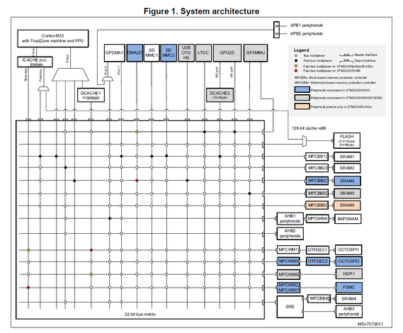

I'm configuring the STM32U599VJT with CubeMX enabling DCACHE1 and 2, as well as ICACHE. Code is generated without error, but functions like SCB_CleanDCache_by_Addr() are not enabled as the definitions in stm32u599xx.h do not include __ICACHE_PRESENT and __DCACHE_PRESENT definitions.

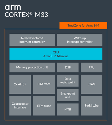

It's my understanding that the CM33 include these features, but how can I enable them?

ICACHE, DCACHE1 and DCACHE2 are ST IPs, not part of the CM33. Refer to figures below from Arm Cortex-M33 Processor Datasheet and STM32U599 RM0456.
They are memory mapped as any other STM32 peripherals in stm32u5a9xx.h as follow:
#define ICACHE_BASE_NS (AHB1PERIPH_BASE_NS + 0x10400UL)
#define DCACHE1_BASE_NS (AHB1PERIPH_BASE_NS + 0x11400UL)
#define DCACHE2_BASE_NS (AHB1PERIPH_BASE_NS + 0x11800UL)
They are managed by stm32u5xx_hal_dcache.c and stm32u5xx_hal_icache.c drivers in ~/STM32U5xx_HAL_Driver.
