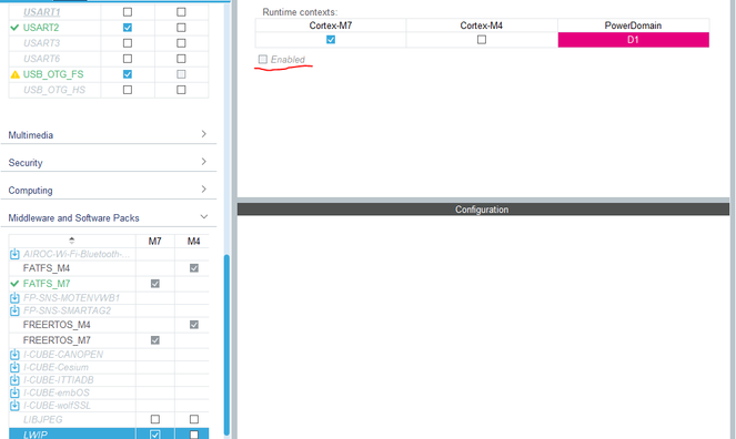

For some reason, I'm not able to enable LWIP on CubeMX 6.11.1, it looks grayed out.

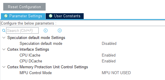

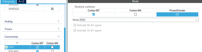

I have enabled ETH in RMII mode and CPU DCache.
However, if I enable both Cortex M7 and M4, then I'm able to enable LWIP. Is this the expected behavior?

Hello @xavierpacheco-eaton and welcome to the ST Community :smiling_face_with_smiling_eyes:.
I've been able to reproduce that issue and i will report it to the concerned team for correction.
