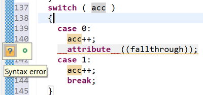

I have
// Prevent a compiler warning on fall-through from one 'case' to another in
// a 'switch' statement
// https://gcc.gnu.org/onlinedocs/gcc/Statement-Attributes.html
#define INTENTIONAL_FALLTHROUGH __attribute__((fallthrough))
But the IDE flags it as a syntax error:
and it's not just the macro:
The usage is correct according to GCC documentation:
https://gcc.gnu.org/onlinedocs/gcc-9.2.0/gcc/Statement-Attributes.html
This is purely in the editor - the actual compiler gives 0 errors and 0 warnings.
IDE v1.13.1 on Win 11.
Seems to be a known Eclipse issue: https://bugs.eclipse.org/bugs/show_bug.cgi?id=567227

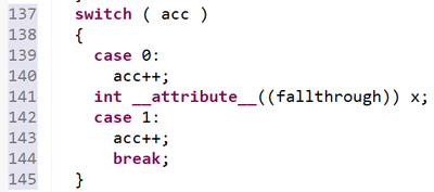

I'm seeing the same in 18.1.1:
(Not real code ;) )
Edited to add:
It looks like the parser doesn't like __attribute__ outside of a declaration, as this is "ok":
Confirmed that 1.13.1 does the same.
I guess the most usual use of __attribute__ is in declarations/definitions - the parser just doesn't handle this "special case"
