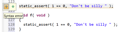

FGrie.3
Mar 11, 2026 8:33 AM UTC
I have a simple workaround: add
// Next 3 lines prevent bogus error reports in _Static_assert and static_assert
#ifndef __BASE_FILE__ // __BASE_FILE__ known to GCC, not IDT
#define _Static_assert(c,m) typedef int static_assertion[(c)?1:-1]
#endif
That should be early in a .c  file, or in a .h file included early, before #include <assert.h> or anything that does, or any use of _Static_assert or static_assert .
I wish the present workaround could be linked to that similar question, which is frozen.
  François Grieu
Radosław
Mar 13, 2026 10:53 AM UTC
Better will be :
To ensures that _Static_assert is recognized properly by the IDE during indexer parsing.
In Project → Properties → C/C++ General → Preprocessor Include Paths, Macros, etc.:
Go to the Providers tab and make sure CDT User Setting Entries is checked.
Then, switch to the Entries tab → expand GNU C under CDT User Setting Entries, and add the following macro:
_Static_assert(a,b)
