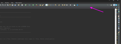

This IDE has gone into some crazy mode where each window maximizes itself on the screen/. I've tried clicking every single maximize/minimize/restore button, closeing the app, restarting the computer.....
This worked and suddenly broke.
Is there some way to make this thing reset back to it's default state?

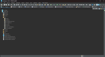

Another screen

Have you tried resetting the perspective (Menu item - Window / Perspective / Reset Perspective...)?

As mentioned by @CTapp.1 :Go to Window in the menu bar. Select Reset Perspective. This will reset the layout to its default configuration and if the issue persists try switching to a new workspace: Go to File > Switch Workspace > Other...

Double clicking in free area on top of window doesnt restore it ?
here ->

This did it, thanks
No, it didn't for me. Thats the first things I tried since I know that double clicking this border area can decouble windows.
I fixed it with "reset perspective" option above

CTRL+M = Maximizie active View or Editor
The root-cause is as you said probably a double-click on a border area or using CTRL+M.
You can of course do a "perspective reset". But an easier fix (less impact on your perspective tweaks) is to hit CTRL+M again to untoggle maxmimization.
