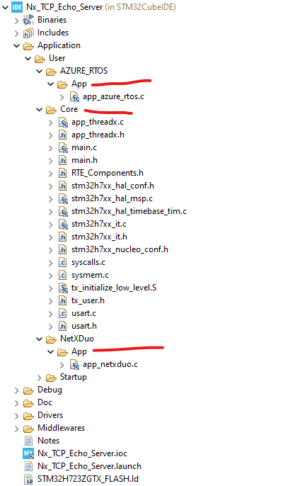

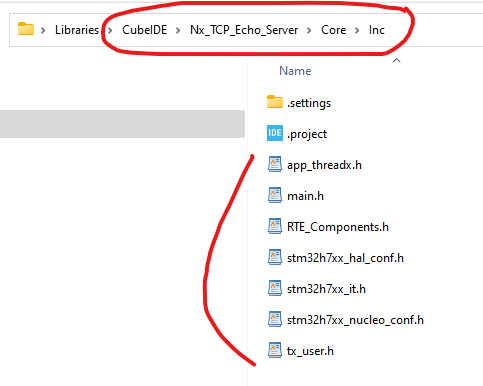

I have imported several example projects into CubeIDE which don't show the header files. The header files do actually exist in the windows file explorer, and the project does properly build and run. So why don't these show up on the CubeIDE (Eclipse) project view? Is there some Eclipse setting that I am missing?

Actually ,in the examples only c-files are shown in the IDE. h-files are not listed. They are only known to the toolchain as include paths. But not visible in the IDE.
This is a known limitations of the example projects.

Really?? No offense, but this makes no sense to me since much of the documentation refers to the .h files for configuration and other information. The .h files are a very important part of understanding how the examples work (or don't work).
Was this intentional?
Is there a way to make the .h files visible?

Thanks for pointing this out. But still, why do the examples follow this form when standard C programming does not. I'm not sure if you are trying to "simplify" the folder structure for beginners, or if there is some other reason. But to me, this is confusing and unnecessary, especially if we plan to use the example as our template for a final project. Just my 2 cents.

The "outline" content is also visible under the file it self in Project Explorer but when I double click or select "Open" from context menu it open tab with the c file not the include. That is confusing!
I agree that it can be opened from different "outline" view, but that is not intuitive at all and inconsistent for sure. In reality one have no idea what is included where so fishing for files like that is not practical.
I think this is the reason for Project explorer view to show relevant .h files. Instead it is detective work looking for them.
I actually prefer that the c and h are in same folder because from human point of view it is more natural even though old IT people would not like that :smiling_face_with_smiling_eyes:.
I really hate that the files are not part of the project and immediately visible in It is confusing and seriously inconvenient. As @MHoop.1 mentioned they are often referenced with folder name which leads to wtf :flushed_face: moment when opening the project.
When using code generator for G0 series it adds c and h files. That that enforces the expectation to see .h in this case as well.
In summary I believe it would be less confusing show .h files in corresponding location. I rest my case ;)
