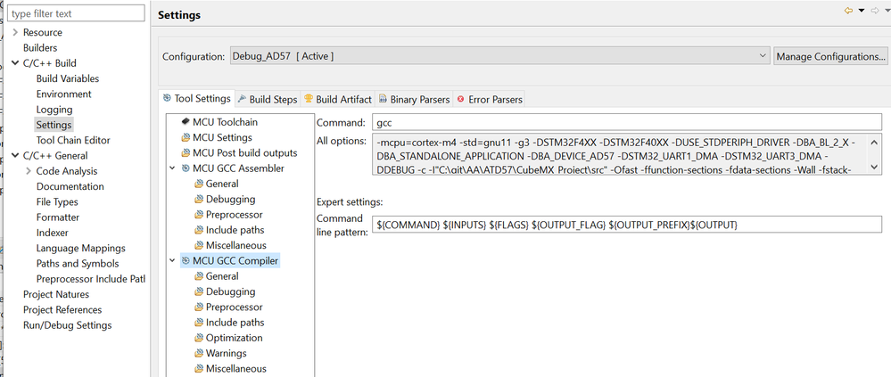

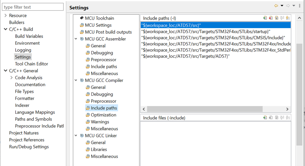

Here's where I entered the include directories (using workspace paths to the directories visible in the project):
If I look at the compiler settings they are reflected correctly:
0693W00000QKt50QAD.pngBut, the generated command line contains only the first of the listed include directories:
Same thing when I try to build; here's the first build command:
arm-none-eabi-gcc "C:/git/AA/ATD57/src/Tests/BaroCalib/ADBaroCalib.c" -mcpu=cortex-m4 -std=gnu11 -g3 -DSTM32F4XX -DSTM32F40XX -DUSE_STDPERIPH_DRIVER -DBA_BL_2_X -DBA_STANDALONE_APPLICATION -DBA_DEVICE_AD57 -DSTM32_UART1_DMA -DSTM32_UART3_DMA -DDEBUG -c -I"C:/git/AA/ATD57/CubeMX_Project/src" -Ofast -ffunction-sections -fdata-sections -Wall -fstack-usage -MMD -MP -MF"src/Tests/BaroCalib/ADBaroCalib.d" -MT"src/Tests/BaroCalib/ADBaroCalib.o" --specs=nano.specs -mfpu=fpv4-sp-d16 -mfloat-abi=hard -mthumb -o "src/Tests/BaroCalib/ADBaroCalib.o"

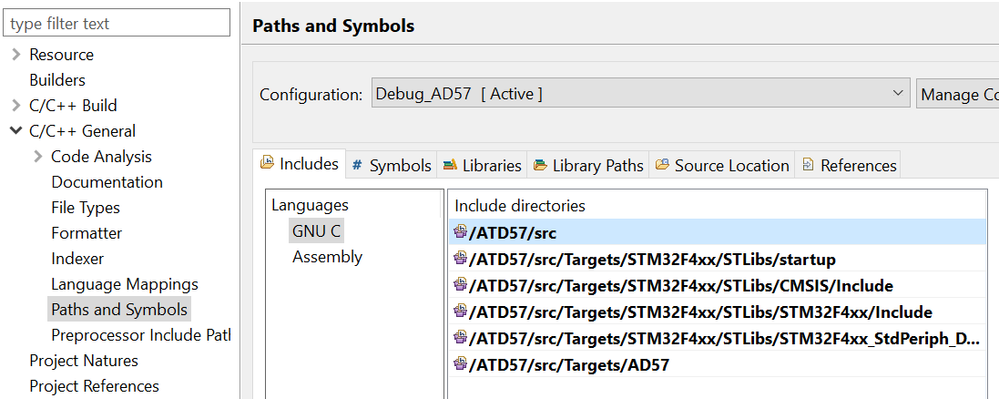

Background
In a project using linked resources, it seems to be impossible to use the linked resource paths from the project in the C include directory entries. So I created workspace paths for the include directories (which in turn depend on the project linkage). All the files in the project are visible and accessible - just cannot get a correct command line for builds.
Any idea what's going on?

Hmm... strange. I use linked resources a lot (though not workspace paths) and never seen such behavior. In the project explorer view, can you see all these include directories resolved?
Everything is visible and accessible in the project view - everything looks fine except building omits everything but the first...
