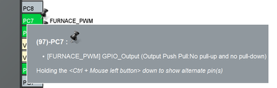

Pin PC7 is correctly set as GPIO output in the IOC:
And after generating code, it's correctly initialized as output within MX_GPIO_Init.
It looks like everything is behaving as intended. What makes you think it's not being initialized?

Again: Include the IOC file of the program you're having trouble with that generates the faulty code. There are no issues with the one you attached, as shown in the screenshots.
It's possible you're not regenerating the code, or looking at a different main.c. In any case, if the issue can't be replicated, it is unlikely to be solved.
