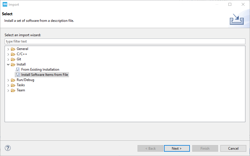

Goof Ball
September 10, 2019
How does one install this plugin into stm32cubeide? The plugin, as downloaded from HighIntegritySystems, is a zip with a .dll, not a .jar
Goof Ball
September 12, 2019
Figgered it out - it is included in @Stefano Oliveri_O​ 's .p2f clump of plugins

Stefano Oliveri
May 14, 2019
Hi Dave,
I am not in the position to answer this question because I am a FAE working with our customers to make their products. But I will say "trust ST".
At the moment I working to figure out how to migrate my projects from TrueSTUDIO to CubeIDE because one thing is very important to me is that CubeIDE is based on the latest Eclipse platform (v4.11.0), and that is enough to make an effort.
I am not seeing bugs, as you reported in your comment, but other missing features.
For the missing features can be useful the attached (p2f) file:
  1. Select the "File > Import" menu command to open the Import wizard
  2. In the "Import / Select" step select "Install Software Items from File" 0690X000008Bg5YQAS.png
  3. In the "Import / Import Software Configuration" step press the "Browse..." button and select the attached file
  4. You will see a list of the missing features plus few other plug-ins I use to manage the whole firmware development life-cycle.
  5. Select what you want and complete the wizard.
I hope this can help to restore your favorite IDE.
