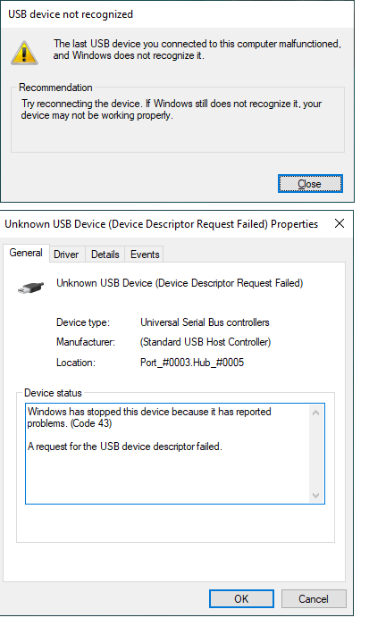

I use STM32CubeIDE1.6.1 to generate USB device (CDC VCP mode) code for STM32G0B1VE. The PC could not recognize the USB. I tried internal HSI48 clock and PLLQ for USB (clock frequency verified by MCO), I pulled up DP through 1.5k resistor by a GPIO after about 2 seconds once starting the code. I'm using Windows 10. Please help!

‎2021-06-30 6:51 AM
Hello @Jackle​ ,
First of all, check the USB connection, and try switching to another USB port.
Then, try increase the heap size of the application. You can follow this article USB device not recognized, it may help you on this issue.
Please keep me informed about your progress on this.

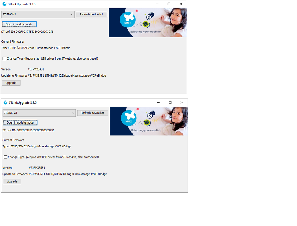

‎2021-06-30 8:13 AM
I recommend you to upgrade the ST-Link firmware version using STM32 ST-LINK Utility: go to ST-LINK>firmware update,
Then disconnect and connect your board.
Imen
Thanks
Imen
‎2021-06-30 8:34 AM
As recommended, the upgrade of ST-Link firmware didn't fix the issue. Still can't recognize the USB.

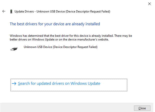

‎2021-06-30 8:40 AM
Did you upgraded the USB driver in the device manager ?
Imen
Thanks
Imen
‎2021-06-30 9:11 AM
I did. But it can't recognize my VCP USB. My debugger works fine. It's just the USB I tried to get as VCP doesn't work.

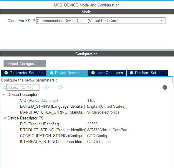

‎2021-07-01 7:50 AM
No, changing PC or board doesn't make any difference.
I can see signals on the DP and DM lines when I just plug in USB.
I suspect it's the PC driver problem or USB device Descriptor problem.
Can you please verify the default setting as shown in the screenshot here?
Please confirm that STM32G0B1VE has been tested with STM32CubeIDE for USB VCP (CDC) device only FS mode so that we will have confidence before digging further. Thanks.

‎2021-07-05 3:19 AM
Hi @Jackle​ ,
I haven't tested this as I'm working from home and I don't have access to that specific board, but that should work.
Have you checked the D+ and D- line? Maybe DP/DM are swapped !
Have you tried to run one of the working STM32Cube examples ? If no, please try this in order to deduce if the problem here seems related to the hardware or software environment or was caused by ST-Link.
