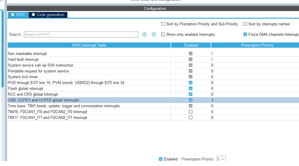

2021-07-27 6:23 AM
2021-07-27 6:31 AM
This is related to your interrupt prio level, at 0 it is in conflict with the systick.
Please put it at 0x3.
2021-07-27 7:49 AM
you mean like this? Still not working.
2021-08-09 8:03 AM
Any progress?@Imen DAHMEN @Nawres GHARBI
2021-08-10 10:28 PM
I also got problem with USB on STM32G0B1 device. Please see my newly post in the "Virtual Com Port Not Recognize STM32G0B1KCT6"
https://community.st.com/s/question/0D53W00000wzdQLSAY/virtual-com-port-not-recognize-stm32g0b1kct6
Solution for me was to enable interrupt in the configuration page shown above. However I would like to know:
Do I need to change the preemption priority level? If so please explain why.
i.e. HAL_NVIC_SetPriority(USB_UCPD1_2_IRQn, 0 or 3, 0);
PS. I consider it a bug in CubeMX, that the interrupt is not enabled automatically (like it is for a F401).
Best regards
Michael
2021-08-11 11:25 AM
I noticed you're using STM32Cube FW_G0 V1.5.0 which is higher version than mine.
So, I downloaded the latest STM32CubeIDE1.7.0. Guess what? It's working now.
I'm not sure what it was. I assume the new version just fixed something.
Thanks go to @MichaelSweden @Imen DAHMEN @Nawres GHARBI
