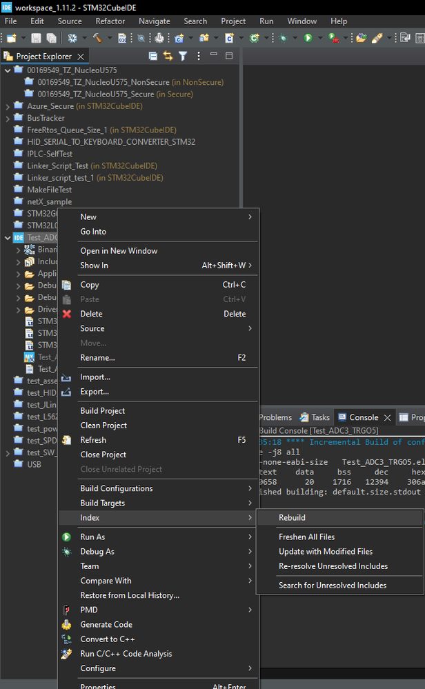

You can start simply by rebuilding the indexer :
- Right click on the project
- Click on Indexer->Rebuild
If the first solution doesn't work try to reset the CubeIDE
And if any of the previous solution doesn't work follow these steps:
- Close the CubeIDE
- Go to the workspace directory
- Go to .metadata\.plugins\org.eclipse.cdt.core
- Delete the *.pdom files
Hope this came to the help.
