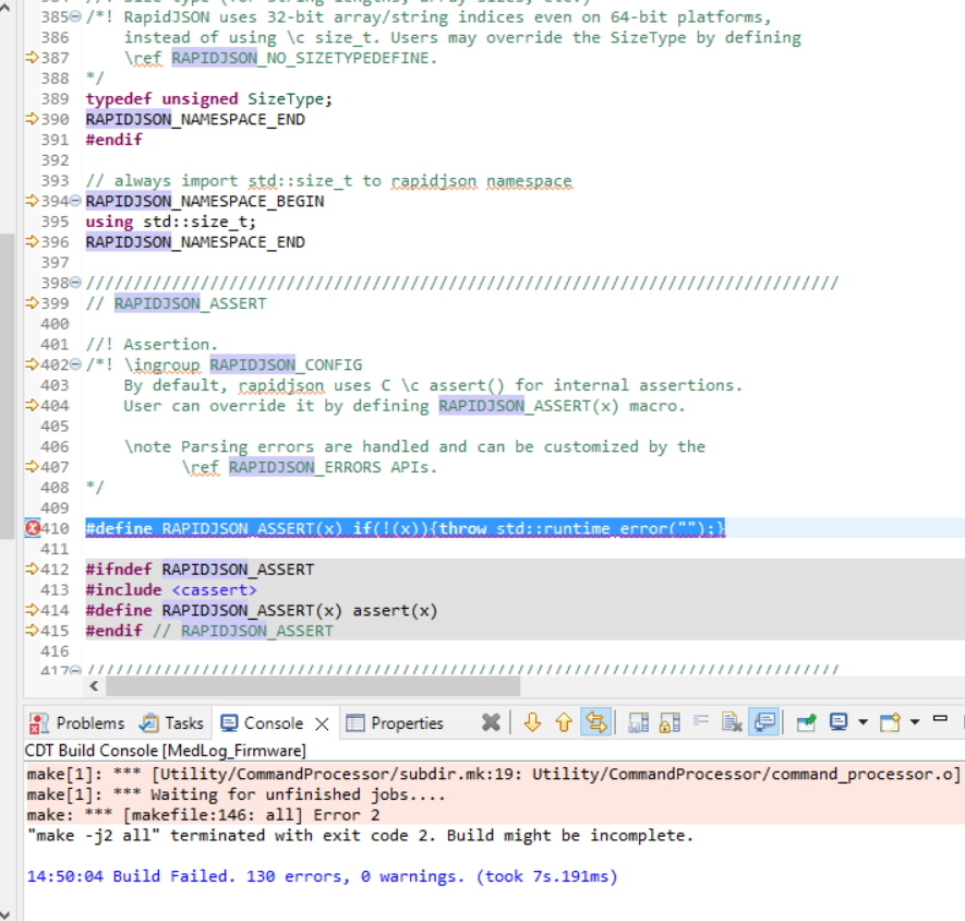

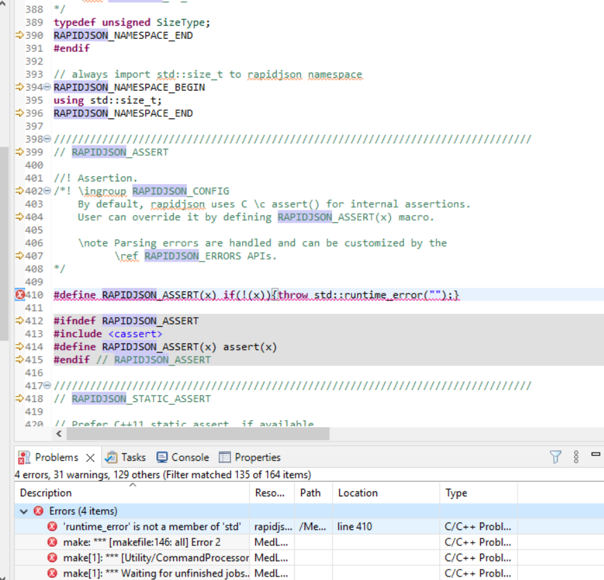

I imported a project (i'm sure it works fine) but i can't build.
Here the errors:
Does anyone can help me?

runtime_error is defined in <stdexcept>, so include that in the file that uses it.
#include <stdexcept>
Note that microcontrollers typically don't use a full C++ implementation and exceptions may not be supported depending on how your project is set up to build (Project Properties -> Tool Settings -> MCU/MPU Settings -> Runtime library). Use the full C++ implementation.

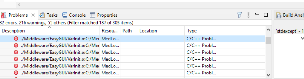

I solved that problem (thankx) but it isn'Senzaewsdfnome.pngt still ok
Your screenshot has cut off any useful error information.
Instead of the 'Problems' view, the 'Console' is more useful - select all in the 'Console' view, then copy & paste as text here.

Sorry for the delay:
make all
arm-none-eabi-g++ -o "Mg_Firmware.elf" @"objects.list"   -mcpu=cortex-m4 -T"../STM32L496ZG_FLASH.ld" --specs=nosys.specs -Wl,-Map="Mg_Firmware.map" -Wl,--gc-sections -static  -mfpu=fpv4-sp-d16 -mfloat-abi=hard -mthumb -Wl,--start-group -lc -lm -lstdc++ -lsupc++ -Wl,--end-group
C:/ST/STM32CubeIDE_1.16.1/STM32CubeIDE/plugins/com.st.stm32cube.ide.mcu.externaltools.gnu-tools-for-stm32.12.3.rel1.win32_1.0.200.202406191623/tools/bin/../lib/gcc/arm-none-eabi/12.3.1/../../../../arm-none-eabi/bin/ld.exe: ./Middleware/EasyGUI/VarInit.o:C:/Mg/Mg_Firmware/Debug/../Middleware/EasyGUI/VarInit.c:33: multiple definition of `GuiVar_phChannel2mV'; ./Middleware/EasyGUI/GuiVar.o:C:/Mg/Mg_Firmware/Debug/../Middleware/EasyGUI/GuiVar.c:59: first defined here
C:/ST/STM32CubeIDE_1.16.1/STM32CubeIDE/plugins/com.st.stm32cube.ide.mcu.externaltools.gnu-tools-for-stm32.12.3.rel1.win32_1.0.200.202406191623/tools/bin/../lib/gcc/arm-none-eabi/12.3.1/../../../../arm-none-eabi/bin/ld.exe: ./Middleware/EasyGUI/VarInit.o:C:/Mg/Mg_Firmware/Debug/../Middleware/EasyGUI/VarInit.c:32: multiple definition of `GuiVar_phChannel2Offset'; ./Middleware/EasyGUI/GuiVar.o:C:/Mg/Mg_Firmware/Debug/../Middleware/EasyGUI/GuiVar.c:61: first defined here
C:/ST/STM32CubeIDE_1.16.1/STM32CubeIDE/plugins/com.st.stm32cube.ide.mcu.externaltools.gnu-tools-for-stm32.12.3.rel1.win32_1.0.200.202406191623/tools/bin/../lib/gcc/arm-none-eabi/12.3.1/../../../../arm-none-eabi/bin/ld.exe: ./Middleware/EasyGUI/VarInit.o:C:/Mg/Mg_Firmware/Debug/../Middleware/EasyGUI/VarInit.c:31: multiple definition of `GuiVar_phChannel2Gain'; ./Middleware/EasyGUI/GuiVar.o:C:/Mg/Mg_Firmware/Debug/../Middleware/EasyGUI/GuiVar.c:58: first defined here

So you have multiple definitions of the variables 'GuiVar_phChannel2mV', 'GuiVar_phChannel2Offset', and 'GuiVar_phChannel2Gain' - from files VarInit.c and GuiVar.c
You need to determine which set to keep, and which to get rid of.
