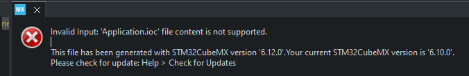

I've just updated my CubeIDE to 1.14.0. When trying to open .ioc I get error about MX compatibilty.
I edited .ioc in a standalone CubeMX 6.12 tool. This error suggests as if CubeIDE had its embedded MX, independed from standalone MX ?
If possible, how do I update CubeIDE's MX version to 6.12 ?

Hello @ferro ,
In order to use the integrated STM32CubeMX 6.12.0, you should update STM32CubeIDE to 1.16.0.
Best Regards.

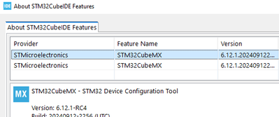

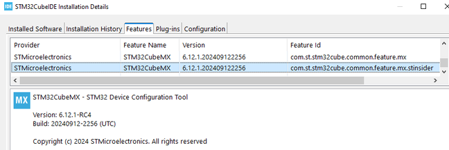

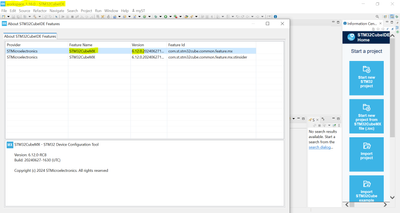

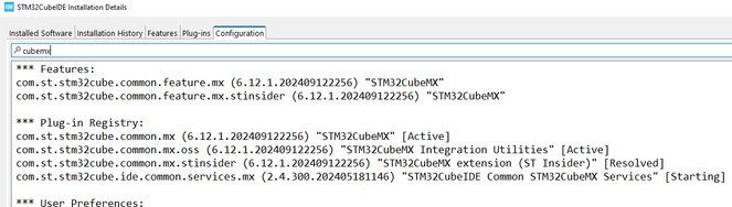

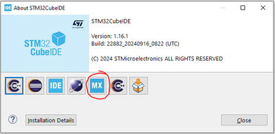

To see MX version:
Help > About STm32CubeIDE > Installation Details >
1. Click the icon
2. Or 'Installation Details'
