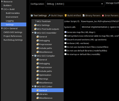

AScha.3

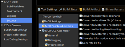

check : generate map file.
show size + list file
here from IDE 1.13.1 ; or 1.14.1 - same.

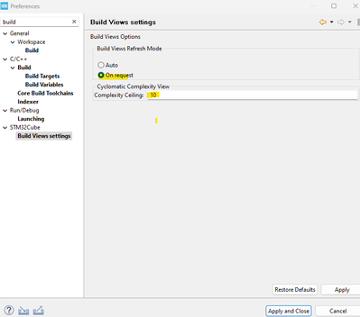

Rim LANDOLSI
Hello @Gianni7315 ,
Could you try selecting the 'On request' option in the Build Views Settings. Then refresh the Build Analyser view using the 'Refresh' button, wait a while and the information will be displayed.
Thanks,
Rim
