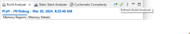

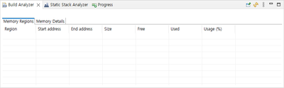

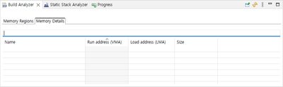

Hi.
I was using STM32CubeIDE 1.14.0 until yesterday.
Build Analyzer worked fine in 1.14.0, but after updating to 1.15.0 using the update feature provided by CubeIDE, nothing is displayed in Build Analyzer.
The build was successful and the <project>.map file was created, but the Build Analyzer information was not displayed, and I uninstalled and reinstalled CubeIDE, but it was the same.

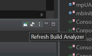

Best answer by christelle burguera
Hello Kim,
You have to click on the "Refresh" button:
Please, refer to the User Manual, section 2.5 where this new button is explained and how you can change the behavior:
BR
Christelle

christelle burguera
March 20, 2024

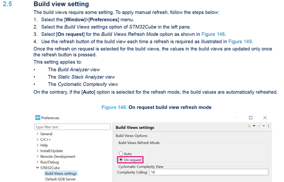

Hello Kim,
BR
Christelle

April 3, 2024
I am having the same issue after 14.1 to 15.0 on Win 11.
I have changed the setting to Auto and still blank in Build Analyzer tab after building. Have restarted IDE.
Additionally, the refresh button is disabled, does not highlight when I mouse over it and clicking it does nothing:
EDIT: My mistake. 'On Request 'does in fact enable the 'Refresh' button and the button perform the functionality correctly.
I assumed that the 'Auto' setting would load the analysis on every build, but alas it does not.
April 6, 2024
Has anyone managed to get the 'auto' option to work, or is there an issue with the 'auto' refresh?
As section 2.5 states:
PR.10

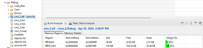

April 25, 2024
yes, see my reply
PHolt.1
Senior
April 6, 2024
Cube IDE has always had a bug in that the Build Analyser would sometimes not show - until you clicked on the .map file in the LH pane.

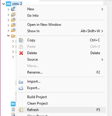

Senior II
November 25, 2024
The build analyzer does have a problem. If the project is not selected and you hit refresh, it won't do anything. Or maybe it tries to refresh from the project that is selected (even if that project is closed) and fails. If only one project is open then the Build Analyzer should always refresh from that project no matter if its selected or not. Or even better the build analyzer should give some warning if its not going to do anything. such as stating that no project is selected. In fact, I think the FreeRTOS warning that pops up when I regenerate is taking the focus selection off of the project which is then making it so that refresh does not work even if the project appears to be selected, without first clicking on the project again.
Whichever engineer decided to include the file with the date and time that the Build Analyzer is using, in the displayed information, made a great decision.
Anyway, if you are hitting refresh and noticing that the information is not refreshing, then select the project or some item in the project and hit refresh again. It should take after that.
