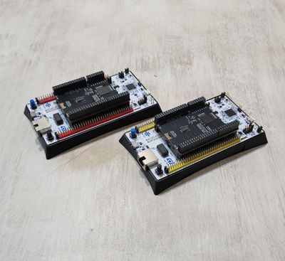

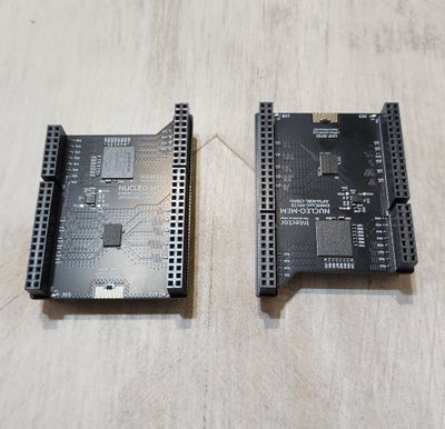

I found a solution to the problems with the AZRTOS Web Server and FTP Server. The main issue was the memory. I found a better memory assignment for all the tasks and got it working. As for the SD card, I made myself a board with an eMMC chip that gave me 8 GByte of storage.
It's the Kingston EMMC08G-MV28-01J10. It works very well on the NUCLEO-H753ZI board. The web server grabs files from the filesystem on the eMMC chip.
I just finished my upgraded "NUCLEO-MEM" board.
This board has the Kingston EMMC08G-MV28-01J10, an APS6408L-OBM-BA 8 MByte PSRAM, and an LXMS21ACMD-220 which is an UHF-RFID Impinj Monza4QT chip. I'm in the middle of testing it and hope it'll run OK.

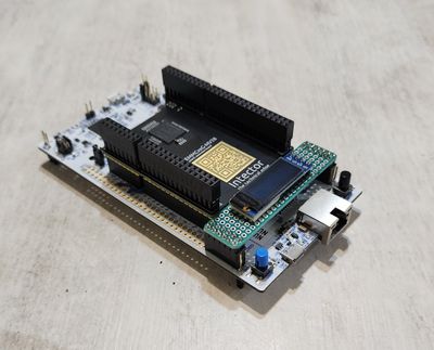

Thanks for the info. I've had it running for quite some time now. I made a GitHub repo for whoever is interested:
intector/Test-XSPI: Working example for the use of XSPI on STM32H7R3L8H6H
It's like a starter project; I thought it'd save others time and frustration.
