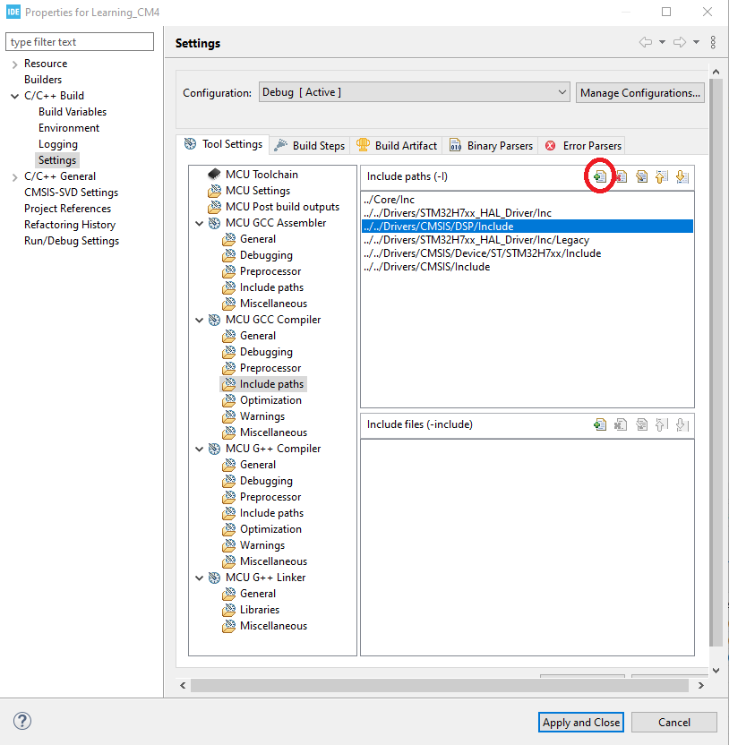

    1. Note that you will have to do this job both in the CM4 as well as the CM7 project. In the Project Explorer of CubeIDE, right-click on one of the projects, like "Learning_CM4" or "Learning_CM7" as shown in my example above and click on "Properties (Alt+Enter)". Add the path highlighted in blue as shown below by clicking on the button encircled in red:0693W00000CzvVkQAJ.png
    2. Notice the selection at the top "Configuration: Debug [Active]". After hitting "Apply", make sure you repeat this for all your other configurations. The same goes for all the following steps, so don't forget to do it (it's a bit cumbersome).

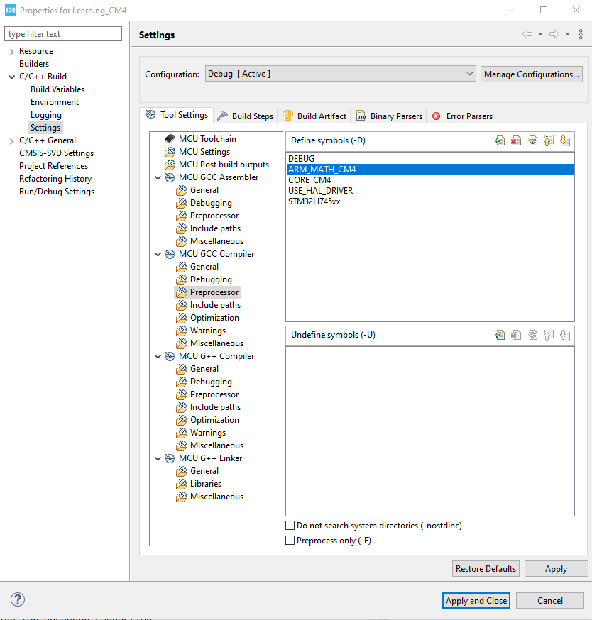

    3. Next add the following symbol as shown below. If you have selected your project for CM4, enter "ARM_MATH_CM4". If you have selected your project for CM7, enter "ARM_MATH_CM7".0693W00000CzvXCQAZ.png
    4. Notice that you did the above for "MCU GCC Compiler -- Preprocessor". I repeated the same for "MCU G++ Compiler -- Preprocessor". You may want to do the same.

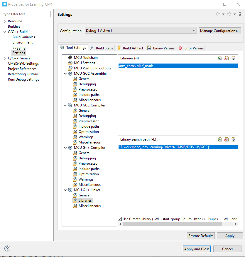

    5. Now comes the part that took me the longest to figure out. For CM4, add library "arm_cortexM4lf_math" if you are in the settings for your CM4 project; use "arm_cortexM7lfdp_math" for your CM7 project. In both cases, you will have to add the proper library search path as shown below. It should be written like follows: "${workspace_loc:/<projectName>/Drivers/CMSIS/DSP/Lib/GCC}". Unfortunately you cannot use "${workspace_loc:/${ProjName}..." as is possible in other places. I think this is a bug.0693W00000CzvWjQAJ.png

the ARM_MATH_CM4 flag is obsolete since about 2019, in newer versions the Flag is not used, it will not cause problem if it set, but it also has no effect. If the flag is set for backward compatibility that makes sense, but it is not needed for the latest versions, but I can not tell you when it was changed exactly.

Hello @Stephan Hörold​ ,
it depends on the version, if you are not sure, it may be better to set ARM_MATH_CM4 or ARM_MATH_CM7, depending on the core. I did not find the exact date of the change(I did not put too much effort in it) and I'm not sure ARM ever stated that they changed in the release, so it was obvious.
