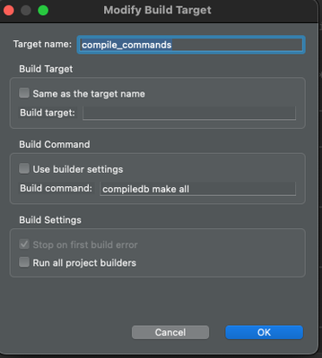

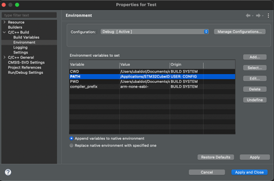

    I found an answer by myself, and it is YES.
    For those who may need it.
    Install a tool that can create a compile_commands.json from a makefile like compiledb or bear (in the following I will use compiledb)
    1) Go on Project->  Properties and change add the folder where compiledb is installed in PATH as shown below.
    2) Go to Project -> Build Targets -> Create... Uncheck all the options and add the custom command you need for creating the compile_commands.json file in the Build commands.
    3) Select the newly created target on the left hand side of CubeIDE, right click and select Build Target.
    4) Once your compile_commands.json is created, you have to move it in the upper folder (root of your project).
    You may have some error related to cyclomatic-complexity, but to solve this is enough to open the compile_commands.json file and remove all the -fcyclomatic-complexity entries.
    OBS! I have just discovered this method, so take it with a grain of salt.

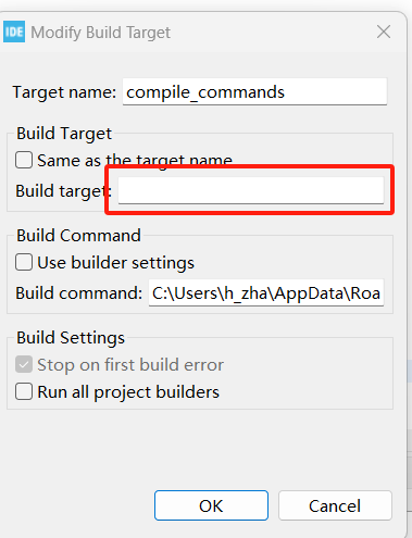

    Thanks for this solution.
    I'm trying to set it up but I got an error: make: *** No rule to make target 'compile_command'. Stop.
    Is there anything to configure with the makefile?
    ubaldotAuthor
    August 15, 2024
    It was long ago, but looking at the screenshots I don't think you need to change the Makefile manually.
    Have you done the step 2) correctly?

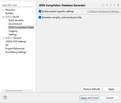

    I am using STM32CubeIDE version 1.19.0 and I have right clicked my project, gone to properties, C/C++ Build, JSON Compiliation Database Generator. ticked the 2 boxes and away it went.
    Visitor II
    August 18, 2025
    Although, I am finging out it does not work in headless mode. As if your building in a docker.... bug or feature?
    It doesn't work in headless mode: https://community.st.com/t5/stm32cubeide-mcus/headless-linux-build-need-compile-commands-json-for-pclintplus/m-p/882423
