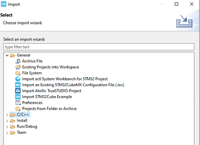

Which import option to choose?
* If the project is created for CubeIDE or already converted to CubeIDE: choose "Existing projects into workspace".
* If the project is for SW4STM32:  choose "Import ac6 ..."  Unless the imported project is in the Projects subtree of a Cube firmware package. Then it is an example, so use "Import STM32Cube example". This will open a special GUI.
* If the project is for Atollic, choose Atollic.
* Else it is not importable automatically.
As for "No specific encoding" - ignore it.

It is best to NOT associate .project and .cproject files with CubeIDE, on any OS. Because these files can be Eclipse projects of any nature, STM32 or not. Also, consider that several CubeIDE versions are installed on one host. Which one should run? For this reason these files are "hidden".
So how do you open these projects? Simple. Start the needed version of CubeIDE (or other Eclipse) and open the needed workspace. Then import the project into that workspace. Next time when you start the CubeIDE you can specify the default workspace to open automatically.
